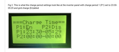

It is possible to set a charge period at the inverter screen if you get stuck with the wifi, let me know how you get on and i'll provide more information on that if you need it.

If you have schedules running, you won't be able to set a charge period on the inverter panel, and you can't reset your schedules without a cloud connection... yep well thought out I know. If you don't have schedules running, you go into the inverter Settings, Work Mode, Charge Time and you will see the 2 charge periods P1/P2, you set the time for a period then set the switch to say 'En' (enabled). (see attached settings for 23:30 to 05:29 note you can set it to run through midnight at the inverter panel)
