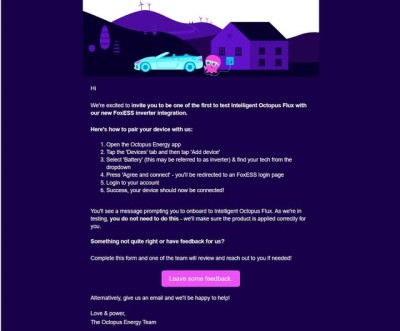

I'm hearing that Octopus are selectively contacting existing Fox customers to test the Intelligent Flux tariff, but only to those that receive the invitation email, - it's definitely getting closer!.timjwc wrote: ↑Fri Dec 05, 2025 11:46 am Hi Dave,

Dave,
Thats encouraging news! I have today emailed Greg Jackson and his CTO asking why it is not yet possible to have my Fox battery on the Intelligent Flux tariff.
I also emailed Fox about their attempts to work with Octopus, and have received advice that Fox is doing just that.
So perhaps I will receive an invitation before long!
