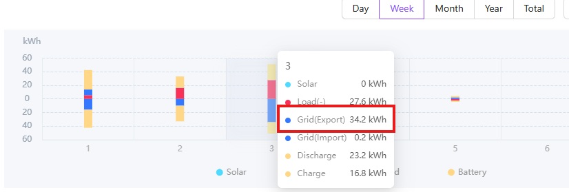

My issue is not SOC.
My issue is that the log file that I exported from FOX Cloud V2 for Wed 02Dec2025 (see attached PLANTaee0b39c-db9d-4968-95f8-cab118853f3d_20251202_27.zip) is inaccurate and doesn't even lineup with FOX Cloud V2 satistical graph (see Cloud Usage Graph.jpg)
According to the export log file, I exported 28.32KW to the grid.
Yet the Fox Cloud usage graph and Amber data show that I exported 34.2KW to the grid
I know the graph data is correct because it lines up with what Amber has recorded.
I was hoping that by raising this issue, someone from Fox would review the data and explain/fix the inaccuracy
