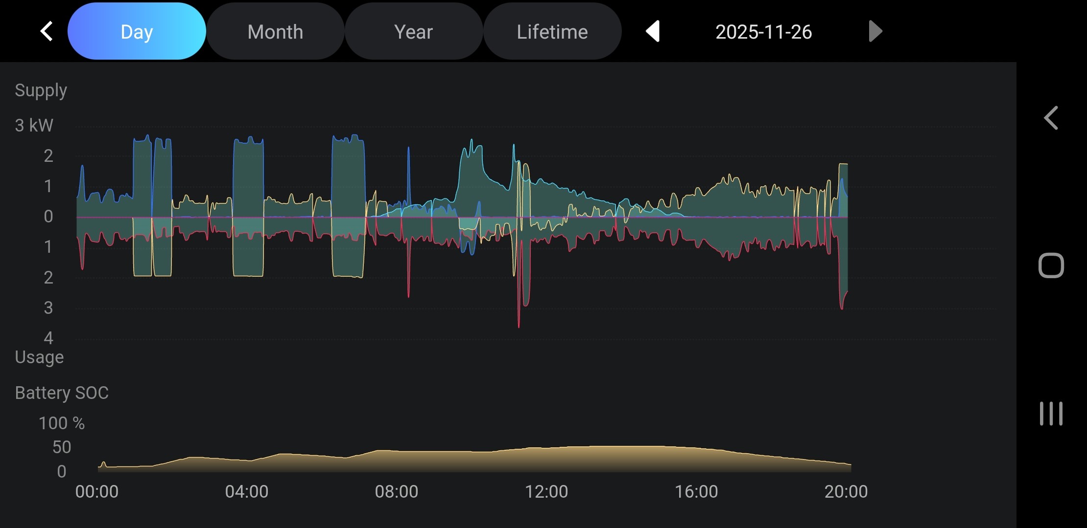

I ask because last night looking at the chart below, it would charge for an hour equating to 15% battery, then stop for about 90mins, then charge for another hour. I can only assume it stopped charging because the batteries got too cold, and then continued once the warming target had been met? Will it also charge if on warming standby? Ive seen someone mention that it wont but i dont see how this could be a thing.
3hrs charging (7hr time period) for 45% capacity is disappointing but it was only charging at 2.5kwh. Due to temp throttling i guess?

From experience with my system from grid the battery will either charge or heat. "Warming standby" is just that - warming is enabled but not active due to cell temp being above the trigger point, the battery should charge in this state.
If charging at the full rate the inverter is capable of your battery should charge from 10 to 100% in 1.5-2 hours if the cell temp is above 11°C at start of charge - the cells will heat further due to the charging process.
