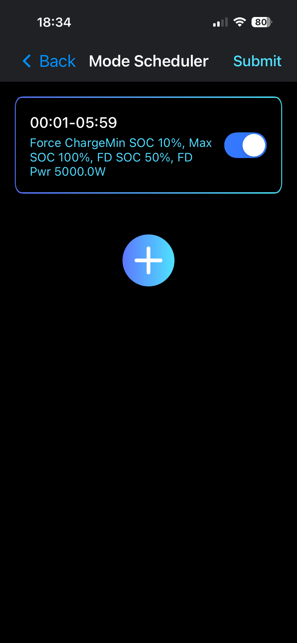

Our newly installed Fox Evo was set under 'Mode Scheduler' to charge 100% last night, but stopped at 50%. It has previously been charging to 100%.
There was nothing set in 'Grid charge settings'.
Any help greatly appreciated.
Doug
You need to set FDSoC the same as MaxSoC - there has been a recent change in latest firmware and FDSoC must be set the same as MaxSoC, it’s because it is at 50% that the inverter stops charging.
