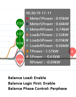

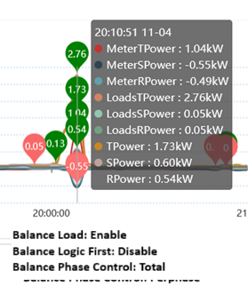

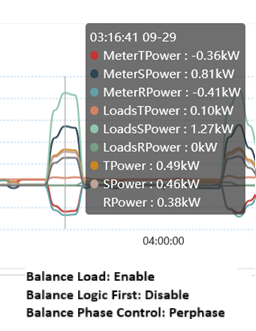

The H3-5.0-E inverter firmware cannot be configured to operate according to the required gross, per-phase behavior. Several configuration modes were tested:
Balance Load
Balance Logic First
Balance Phase Control
In all tested configurations, there are cases where the firmware attempts to balance the power of the three phases to reach a “net-zero” state.
Observed Behavior
The inverter redistributes power between phases in real time.
The system feeds energy into one phase while consuming on another, leading to double billing for the same energy.
Financial Impact
This malfunction causes direct financial loss:
The user is charged for energy that was already exported on another phase.
The inverter’s unnecessary phase balancing discharges the battery, causing energy losses and reduced efficiency.
Overall, the issue results in overbilling and battery degradation, leading to financial loss.
