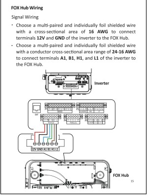

System is new and supplier will not answer questions. I have a code 1148 on fox ess 11.4 inverter, hub g2, there is a dongal on inverter none on hub. There is no communication line between inverter and hub, is the the problem? Can I just add a 2nd dongal?

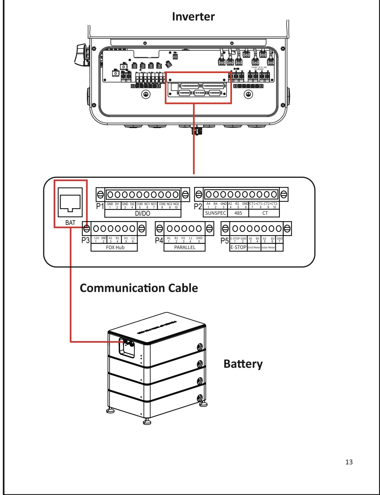

An AI search for code 1148 returns this (which seems about right) - i’m assuming you have either an all in one or a single phase inverter with battery in which case their should be a cable from the inverter to the battery or from the inverter to the hub (a CAN bus cable which looks similar to an ethernet cable on the battery and a multi-core cable to the HUB - see the attached).

Thanks for the reply. There is a ethernet cable between the inverter and the battery but none between the inverter and hub. I have checked the connection and did a shutdown and restart but still getting the code. How can I as an end user check the or updated the firmware?
