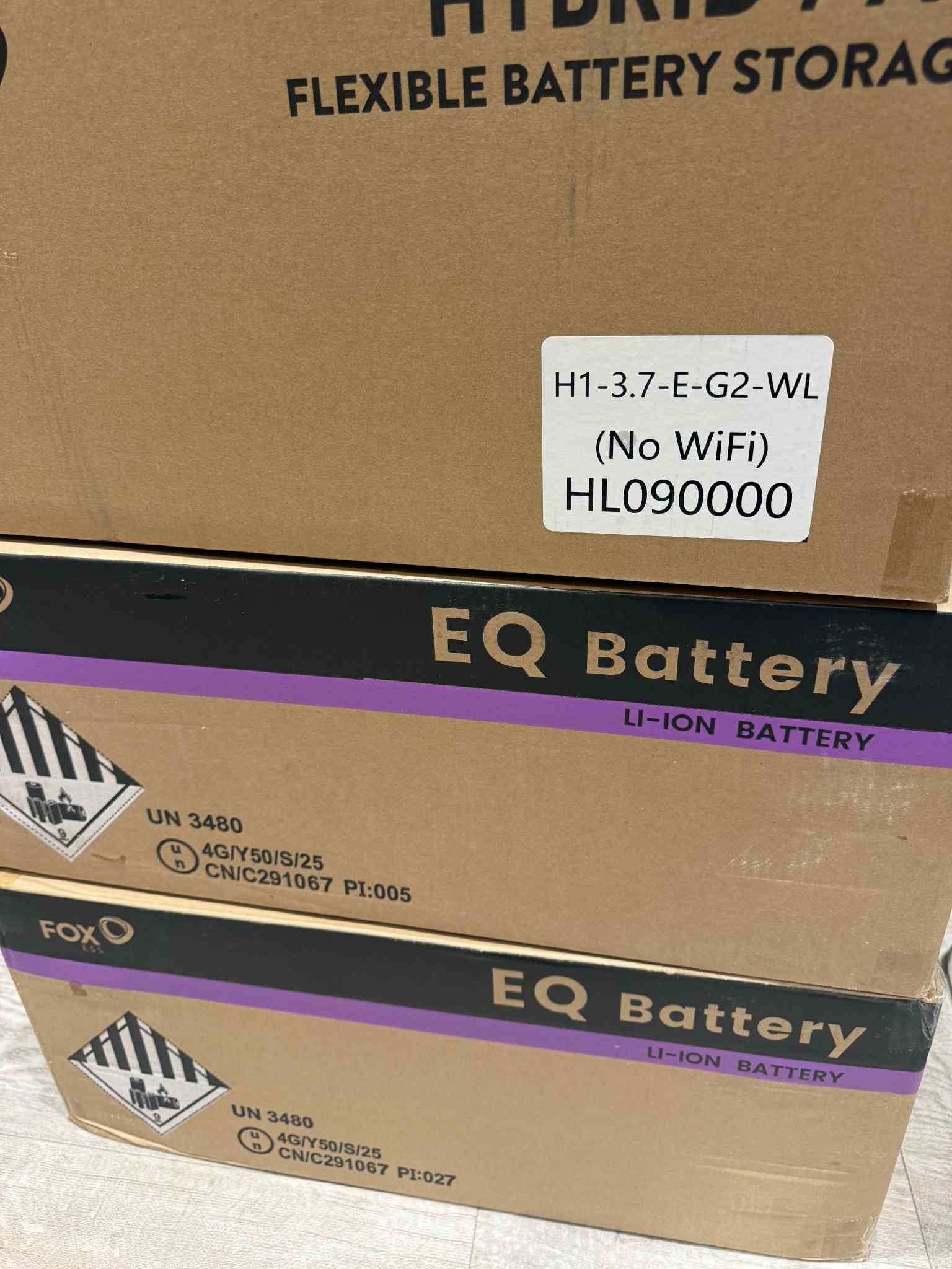

Hi Jim,
I'm swapping a customers inverter this week that the charging relay has failed within.
Fox have provided an H1-3.7-gen2-WL with a big sticker saying "no wifi". Just wondering if your Gen2 WL still states no wifi on the box even though it has integrated wifi.

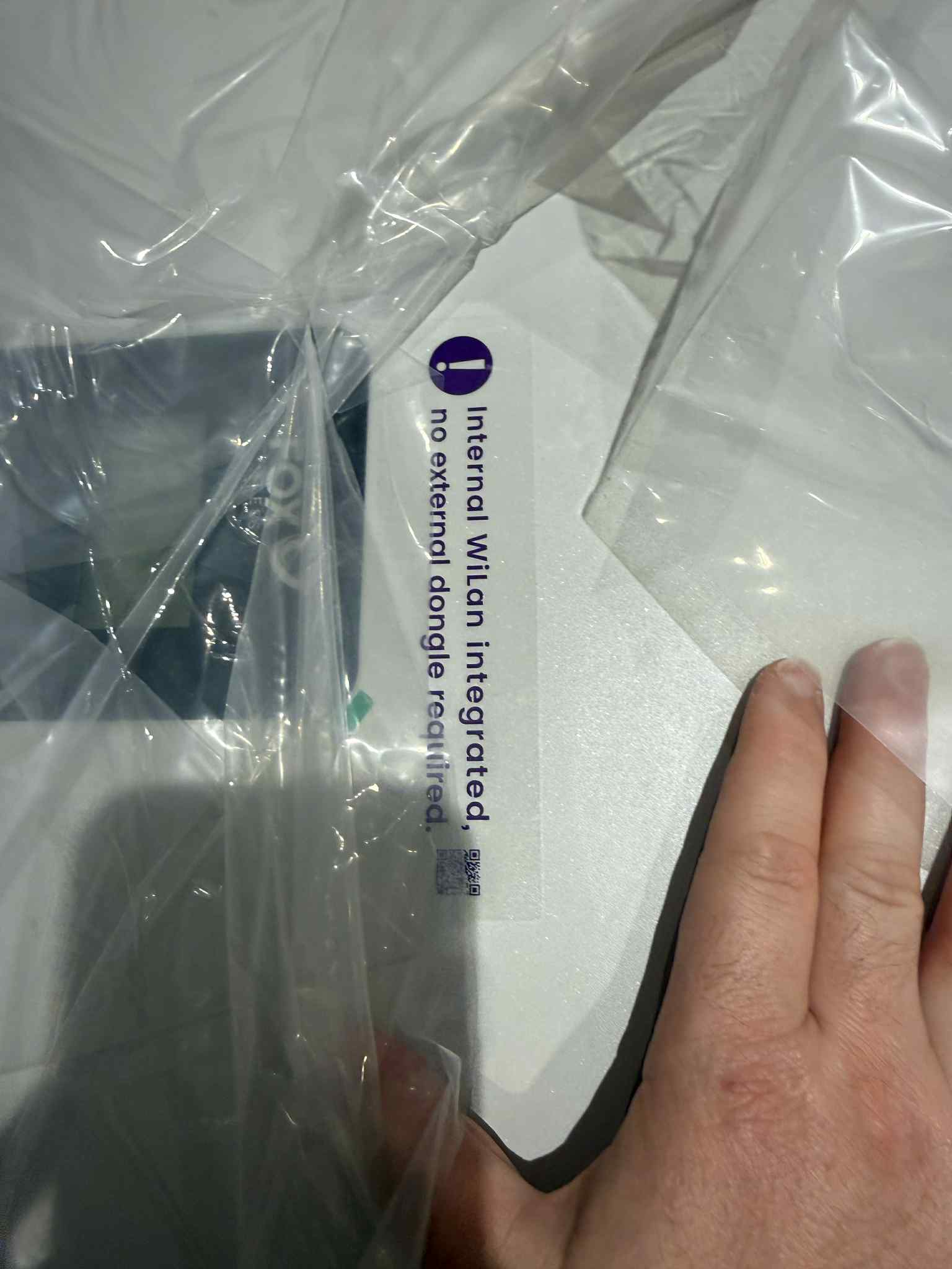

Re: H1-5.0-E-2 ‘bricked’ by firmware update….
Following on from our DM, it does include an integrated wifi unit even though the outside says no wifi.
Yup - my replacement is the same - strange box label - perhaps it means no WiFi dongle included/needed?
