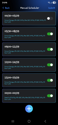

This is how I had set it the previous night (I had to recreate for screenshot)
I then checked this in the morning, to see that it had set every entry to force charge
After I had programmed it back to correct settings, upon checking it just over an hour later, it had charged battery back to 100% and modified values again

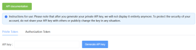

The only API key I have used it the Octopus one, where I input this into Fox when I was on Agile tariff.
I don't recall ever making or seeing my Fox API key.
ETA: I have just logged into Fox to view my API key, it is blank... so I guess I never made one in the past.

Attached is screenshot from API screen, I presume this means I never have asked for one as it is not seen partially?

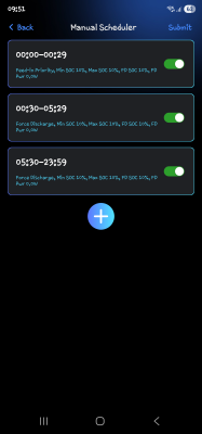

I had set the scheduler to Octopus Go tariff yesterday evening, and shortly after midnight I had to set the 00:30 - 05:29 Charge window again, as it had swapped to discharge.
When I woke up and checked scheduler again in the morning, it had set itself Force Discharge in slots 2 & 3 of the scheduler as seen here

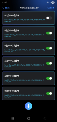

I then decided to try and remove the schedules via the foxesscloud website to see if this could make a difference (as I usually set via phone app.) I am trying this way to see if there is some bug in the phone app (for me) or maybe it "sticks" better if I set via the cloud website.

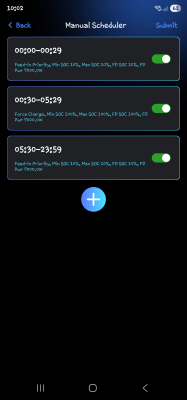

It kind of worked, as when I first checked on the phone afterwards, it had set the 3x schedule entries, but with some odd settings. At first when I looked on the phone, it had all 3x schedules set with FD SOC as 20%, and FD Pwr as 100.0 W.
I corrected these values, to what I think should be correct, and have this now saved.
EDIT: I left the phone app for about 1hr, and when I checked, it had swapped the 00:30 - 05:29 Charge to Discharge again.
