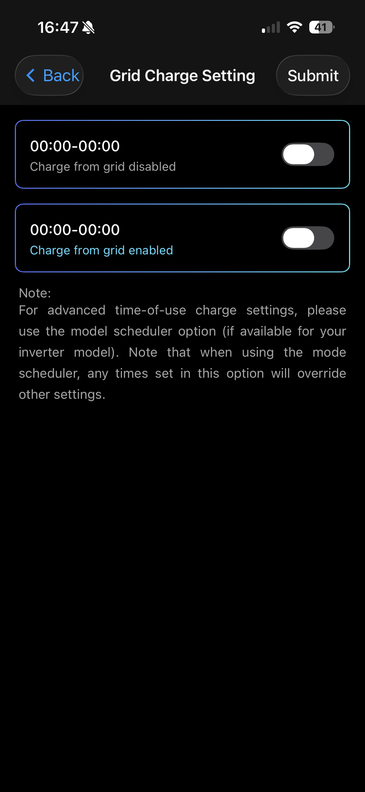

I have set the two time periods in the grid charge settings several times and each time it says “operation successful” yet as you can see from my screenshot when I close and re-open the app it has reset to midnight-midnight.
Why is it not keeping the settings?!

When you have set them, make sure you click ‘Submit’ in the top right corner of the screen and that will send them to the inverter in real time.
I’ve found the app doesn’t refresh properly, so I either force to refresh by pulling down on the screen, or force close the app and re-open it.
The only other thing to mention is you cannot use these charge periods and the mode scheduler at the same time, the scheduler will always reset these time periods.

Yeh I’ve done all of that and no change. It still doesn’t reflect what I’ve entered into it.
Mode scheduler is off. Ive even tried deleting and re-installing the app.

The only thing I can think of to cause this is that your Manager has crashed, that will need you to do a full shutdown and restart to reset.
