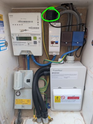

It’s possible the CT clamp itself has either failed or become unclipped - you can check for being unclipped easily - have a look in your meter box, you should be seeing a CT clamp (a small square clip) clipped to the live feed from your smart meter - if in doubt post a picture here.

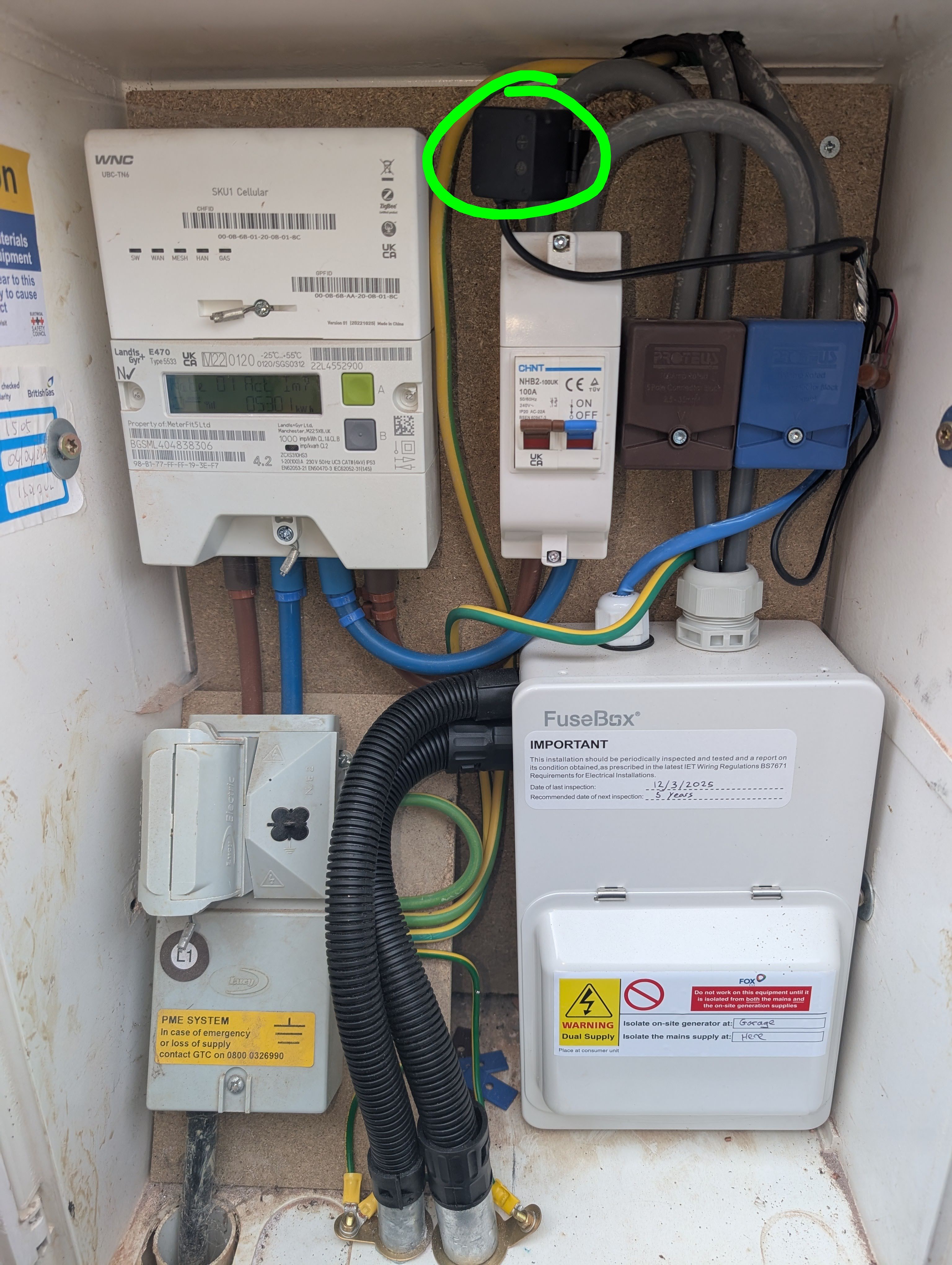

Is this the CT clamp ?
It does seem to be clipped around the the live feed from the smart meter - so does that mean that a likely cause is that the CT clamp has failed ?
Yes that’s it, and it is clipped on ok.
I can see the cable appears to have been shortened and looks like it has connectors - if your CT is not reporting the load properly I wonder if a poor connection here might be the cause, it’s a common failure point.
