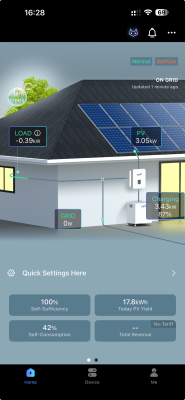

Is this a clue, look at the load and grid while it's discharging. My home is using barely any power right now, just fridge, wifi etc.
An recharging seems to make load negative, and octopus says we are pulling constant 500w from the grid, which equates to the difference between the PV and negative grid....

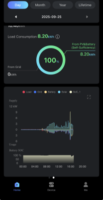

If you swipe left on that screen can you screen shot the graph and battery soc towards the bottom of that page.

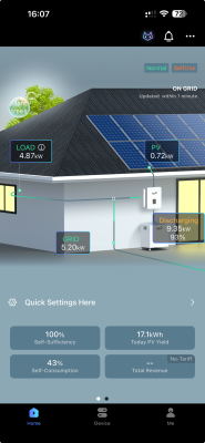

Just to clarify for me, it looks like you set the inverter to Force Discharge at full power and you can see the R/S/TPower shows that each phase is outputting 3.39kW which is what you would expect.
The problem then is that the power measured by the meter for each phase is lower on 2 phases and much lower on the RPower - that suggests a load is taking the difference so that would be approx 1.3kW on T phase, 0.8kW on S phase and 2.7kW on R phase - which would show a combined load of around 4.8kW, but there was no load on in the house ?

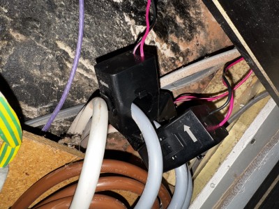

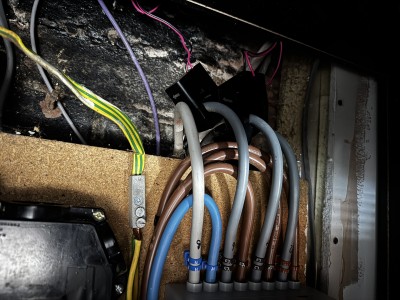

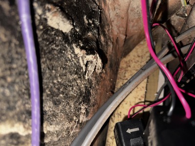

Could you grab a couple of pictures of your meter cupboard, if there are any CT clamps could you get close ups - I may need a few but i’m now sure what i’m looking at yet, probably know more when I see them.

Correct about the force discharge at 4pm. Just a trial to test it worked.

Couple pics here. Hard to get a decent angle as buried in a cupboard! The arrows point at the consumer unit.

As this install is using CT clamps it is possible they have entered the wrong transformer ratio in the meter so when you are taking 3kW, the CT’s / meter is only measuring 2kW (you can see that above) - that could be why it’s only showing a 2kW export per phase when it knows it is delivering 3.39kW per phase and so it calculates the rest is being taken by a load.
