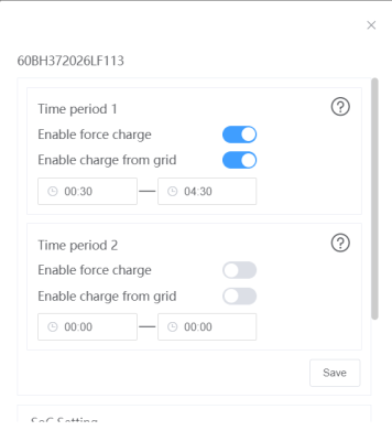

I have set the SOC to 10% and the force charging+ charge enabled settings to charge between 00:30 - 04:30 as below.
But the batteries are charging at 22:00 at 0.45Kw see below, this has happened several time times since the battery install was completed.
Has anyone else experienced this? I do not want my batteries charging when my electricity is expensive!
