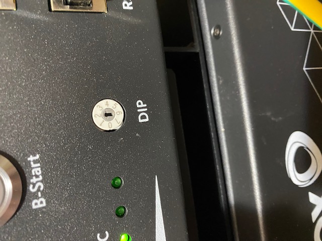

You've mentioned the rotary dip switch, which should be set to '4' with 6 batteries, if you are adding another it needs to be set to '5' - all of the addr dip switches should be set off on all batteries.

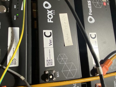

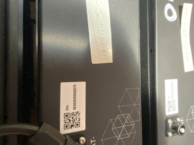

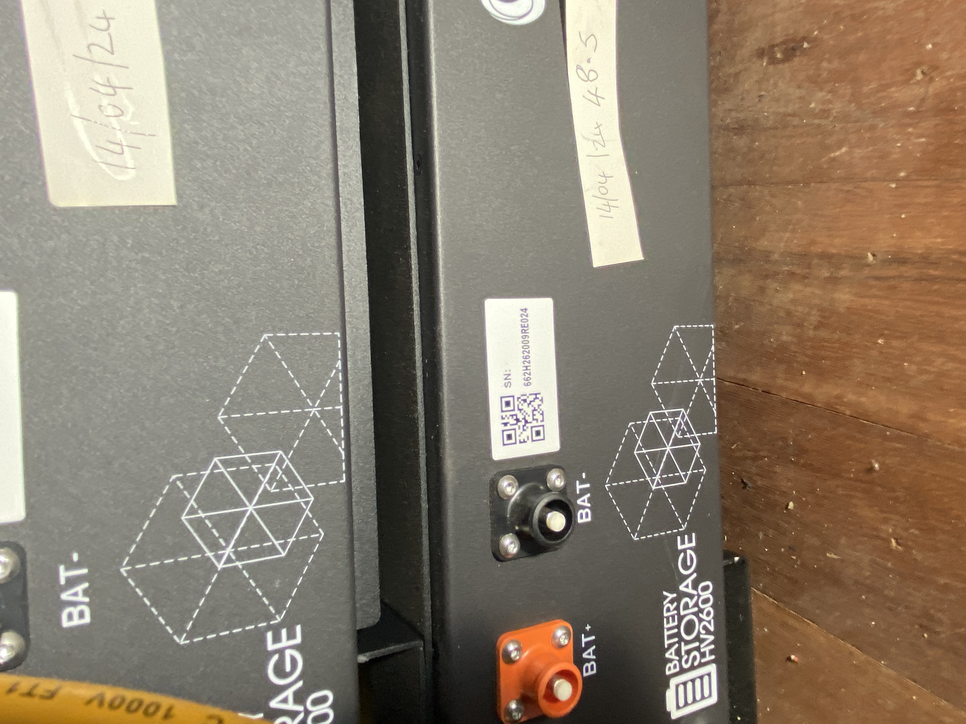

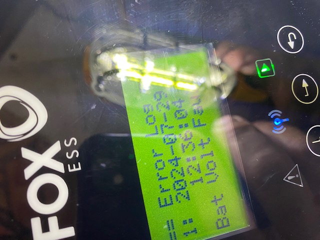

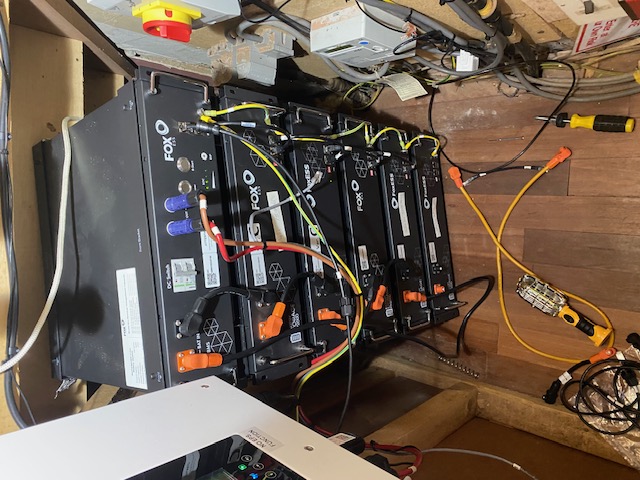

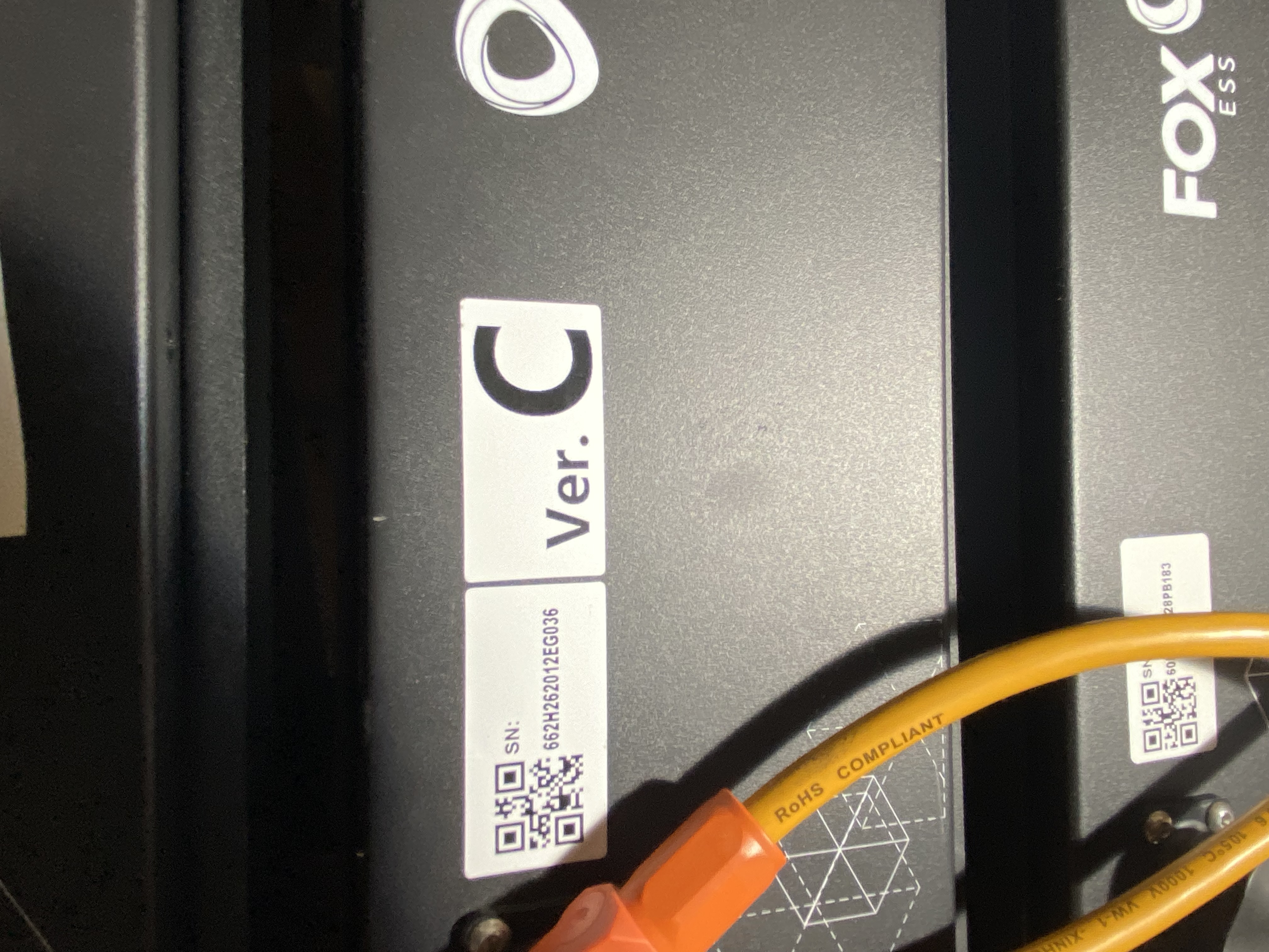

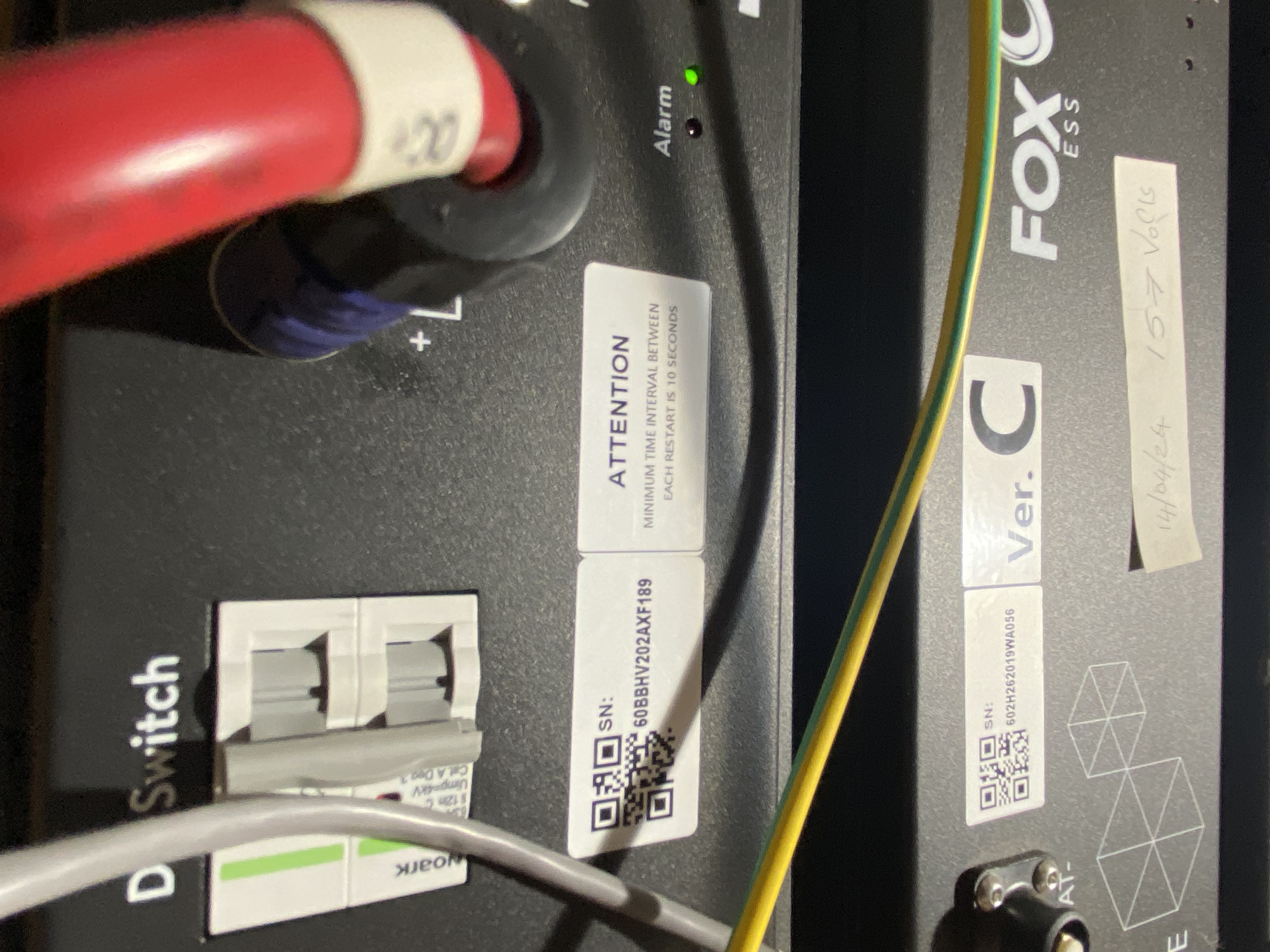

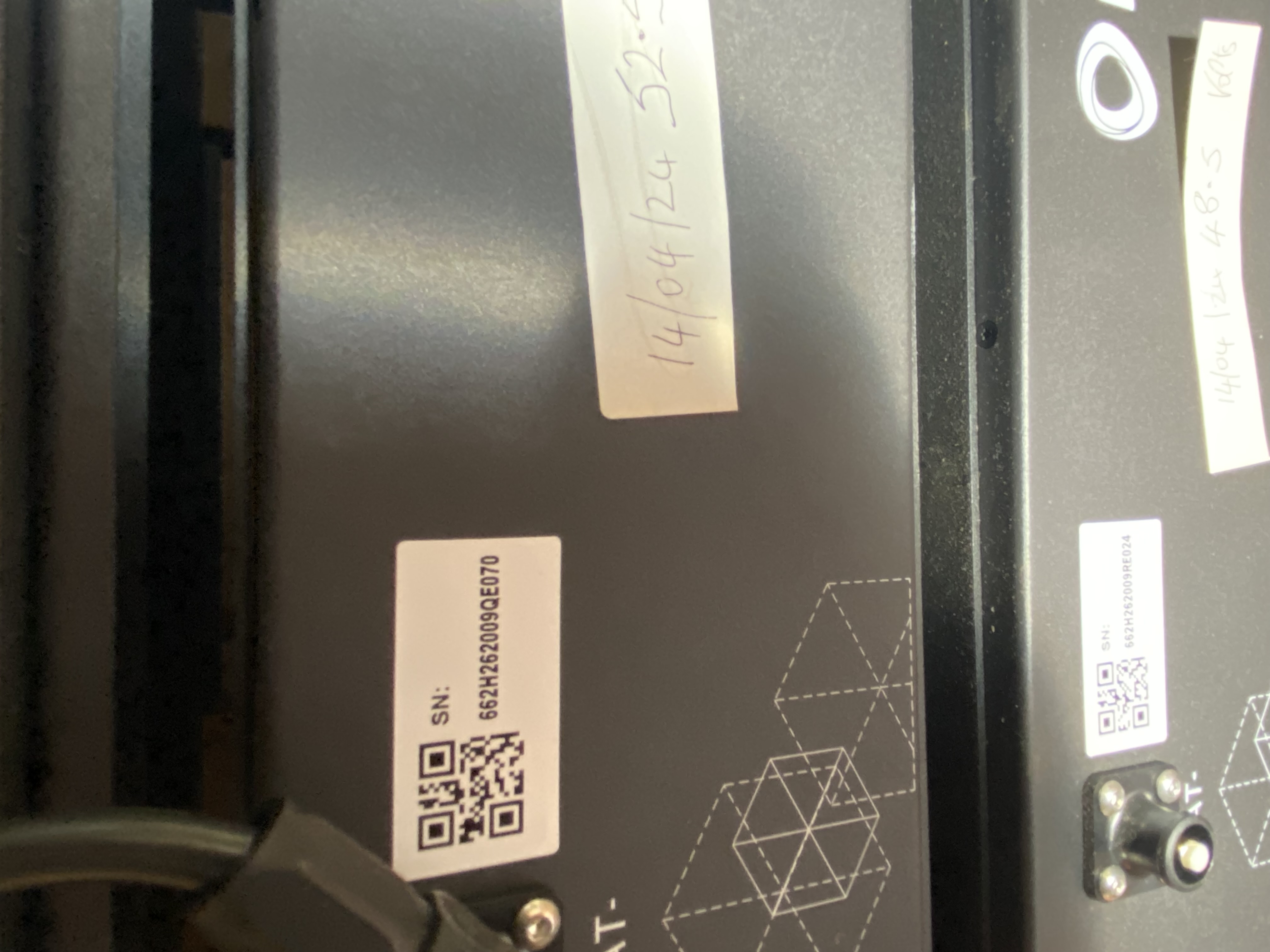

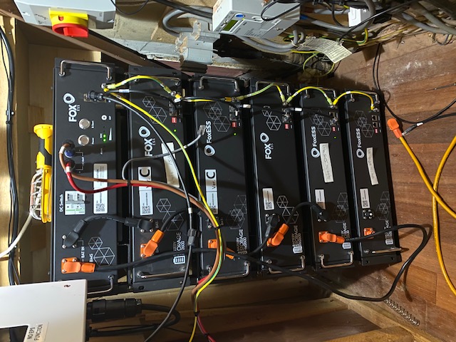

hi Dave Foster Thank you for your input as you suggested we have reorganised batteries putting the v2 on top and the dip switch to number2 for 4 batteries I have a fault i.e battery volt fault I have put up a few jpegs
if you would have a look for me please and would appreciate any advice thank you

Did you re-organise it after those pictures - the ones marked Rev C are V1 batteries but they are at the top of the stack ?
The photo resolution isn't clear enough for me to see what each of the lower batteries is, but i'm assuming they must be the V2's
The bat volt fault is an indication that battery volts are not correct, so to start if on the inverter you click System, Battery and it will show the voltage being presented to the Inverter (it should be approx 220V for 4 batteries)
Do you have a DC meter that you can measure the voltage of each battery pack ? - they should be reporting somewhere between 48V and 58V each, but if they have been left disconnected for some time they may have self discharged (or worse the internal fuse may have blown) you need to establish whether all of the batteries are working.

Your pictures show 2 * HV2600 V1's as the first 2 batteries (and it should be V2's first), but the firmware versions you posted don't make sense as that suggests battery 1 & 3 are V1's and the firmware on battery 2 is really old.
I think you need to be more methodical about this, you should have your V2 batteries as the first in line after the BMS and then the V1 batteries last - so V2 at the top, V1's at the bottom.
But you need to know the batteries are still healthy which needs the battery voltage measuring on each battery - anything less than 48V on each battery, at this stage you should remove it from the stack and deal with that later.
That way you might be able to build a stack of batteries that don't trigger a voltage fault and would allow you to get some charge into the batteries - plus looking at the age of the firmware you need to get the firmware updated as well, which Fox will do if you email them your inverter serial number, but you must first get an operational stack.
