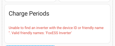

I've been playing with HA integration as well, I tried to get the Charge Period Card running but get the error below:Dave Foster wrote: ↑Thu Jul 04, 2024 3:52 pm I'd recommend you download the charge card which lets you see the normal charge periods https://github.com/nathanmarlor/foxess_ ... eriod_card
I've made sure my (Modbus) integration is named FoxESS Inverter - am I being thick?

It’s working for me on my H1, do you have the latest version of the modbus integration ? - also when you have added the card, add it to the dashboard and then go into Edit, in the left hand pane under config you should see a drop down box, drop that down and select your inverter name - save.markhaines wrote: ↑Tue Jul 16, 2024 9:42 pmI've been playing with HA integration as well, I tried to get the Charge Period Card running but get the error below:Dave Foster wrote: ↑Thu Jul 04, 2024 3:52 pm I'd recommend you download the charge card which lets you see the normal charge periods https://github.com/nathanmarlor/foxess_ ... eriod_card
