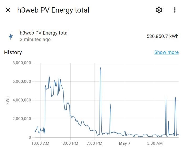

If anyone's had the same problem. Since yesterday the daily and total values are not displayed correctly in HA. Momentary values are correct.
As example :
h3web Battery Discharge daily
5,435.5 kWh
h3web Feed-in daily
6,534.3 kWh
Raw data from ESPHome are correct. Example:
[09:22:03][D][modbus_controller.sensor:025]: Sensor new state: 18.00
[09:22:03][D][sensor:093]: 'PV Energy daily': Sending state 1.80000 kWh with 1 decimals of accuracy
FoxESS Hybrid-WR H3-8.0-E
FoxESS Batterie ECM 2900 Master/Slave with BMS
LiFePo4, 2,9 kWh x 3
Astronergy PV Modul CHSM54M-HC BL 400Wp x 20

Seems it is issue between HA<----->ESPHome communication. Raw data in ESPHome is correct for Total too.
Example:
[09:22:03][D][modbus_controller.sensor:025]: Sensor new state: 5137.00
[09:22:03][D][sensor:093]: 'Battery Charge total': Sending state 513.70001 kWh with 1 decimals of accuracy
[09:22:03][D][modbus_controller.sensor:025]: Sensor new state: 17466.00
[09:22:03][D][sensor:093]: 'PV Energy total': Sending state 1746.59998 kWh with 1 decimals of accuracy
