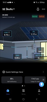

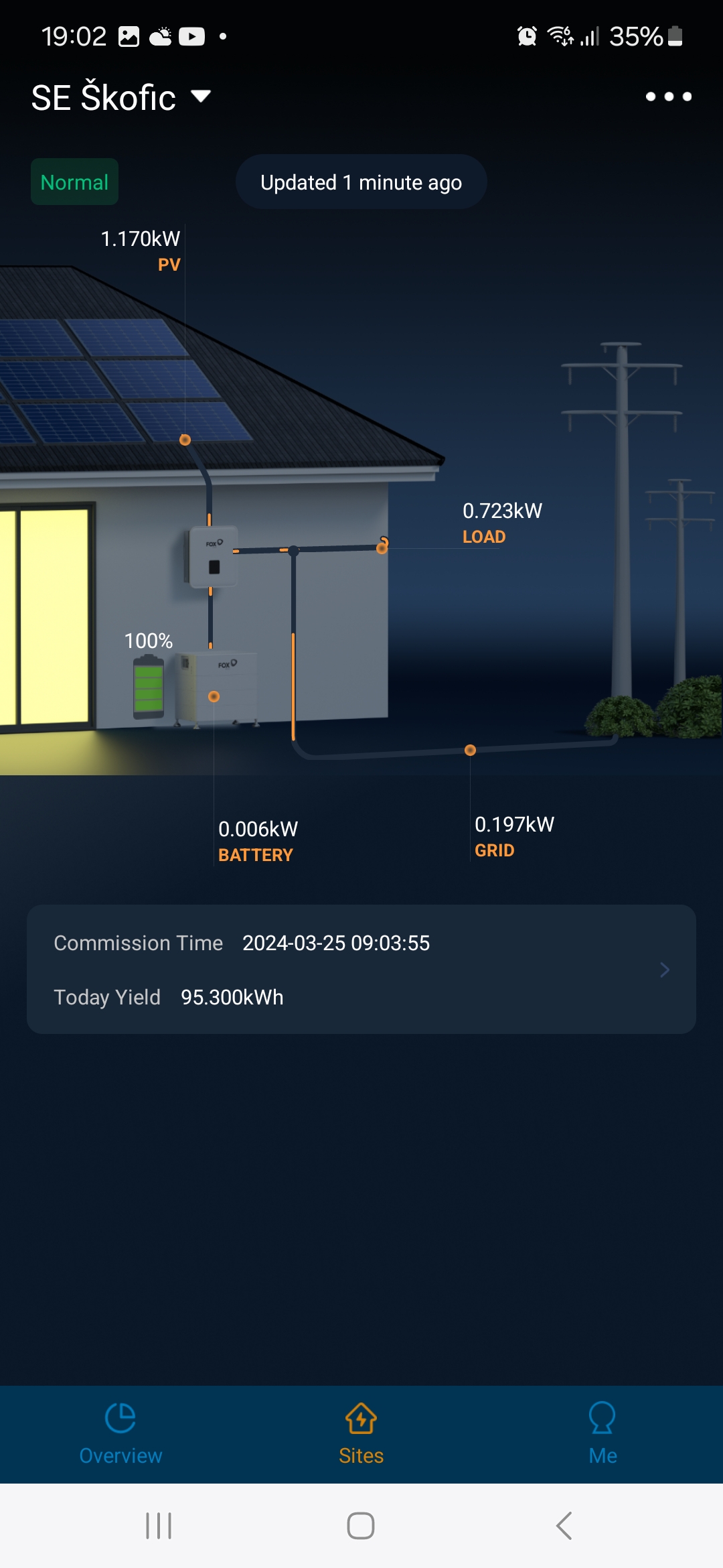

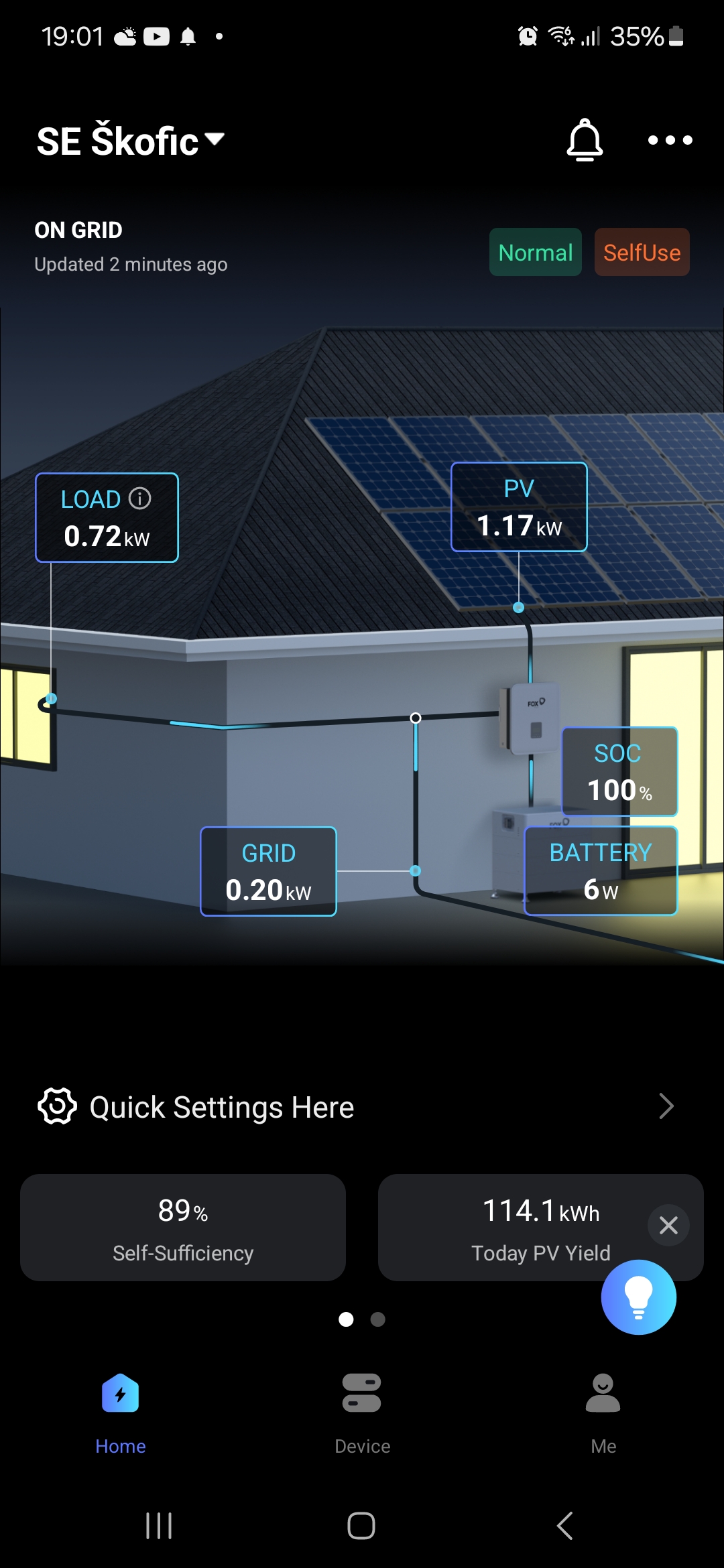

Hello, can someone please tell me which of these numbers from todays yield is correct? I have both of these apps and they show each different today's yield. I want to know from the solar panels itself generated energy.

Assuming the Fox v2.0 app is the latest version, that figure is the "true" PV generation alone, whereas the original app shows the inverter yield including what has come from the batteries.
