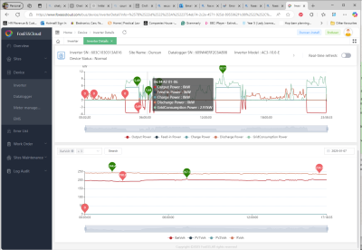

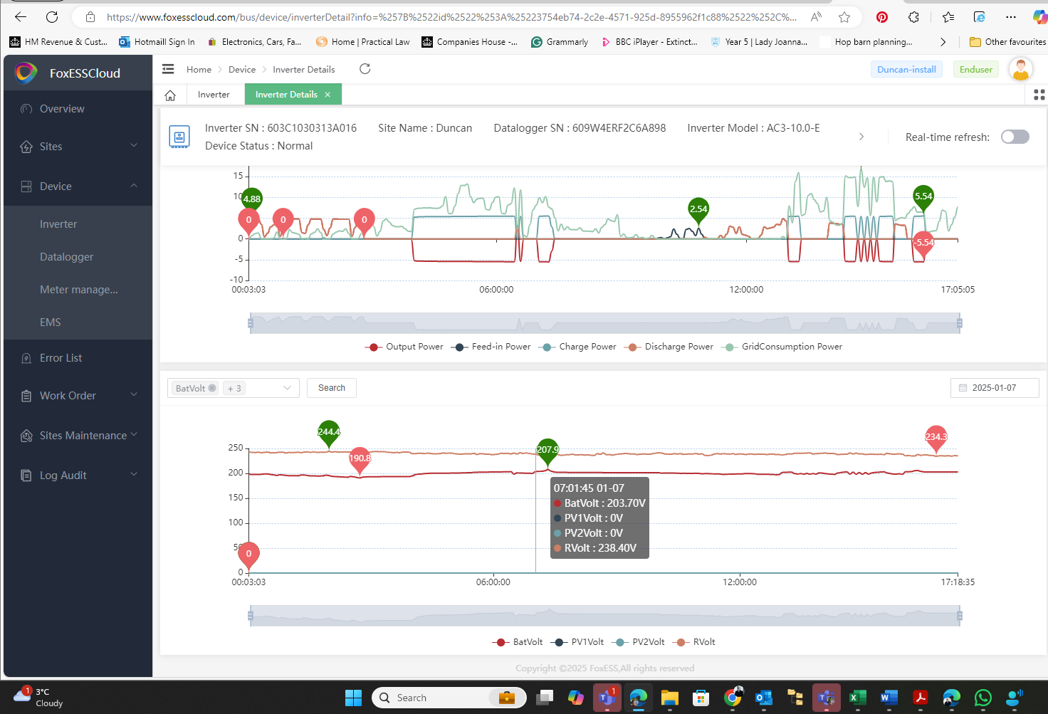

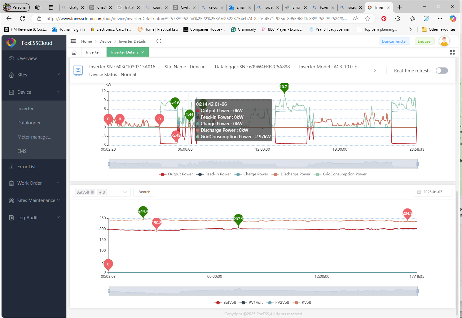

Can you go to the foxesscloud.com website, log in and go to the Inverter, Details screen - it’s the one that has the ‘Energy Flow’ under the ‘Device Status’ at the bottom of that screen is a blank graph with a drop down menu that allows you to select the sensors you want to view.
If you can select PV1Volt, PV2Volt, BatVolt and RVolt and click search.
If you can screen shot and attach the graph here and the approx times of your error 64 so I can cross check against those traces please.

the batteries received a full charge between 4-7am
I have set the cursor at just after 7am when the batteries were supposed to start discharging but you'll see that they didnt until much later.
I was about to confirm when the error code happened but there wasnt one today!
Ok, I'll try that again

ok, so here is the screenshot with the exact time when the error code 64 occurred

- Posts: 1786
Ok yes your inverter is dropping out when it has the fault and falling back to its checking state which is why you’re seeing the charge interrupted as the inverter has gone off-line in error.
There is nothing obvious in the traces, the voltages are in line with what you would expect but what they don’t show is fast changes that might cause an error but not be visible in the graphs.
You might want to ask your installer back as I would suggest a thorough check of all the dc connections between the inverter and the battery and that an earth is in place between the two. I think also worth making sure the inverter has the latest versions of Master/Manager firmware installed - Fox service can check and update the firmware for you if you email them with your inverter serial number.
