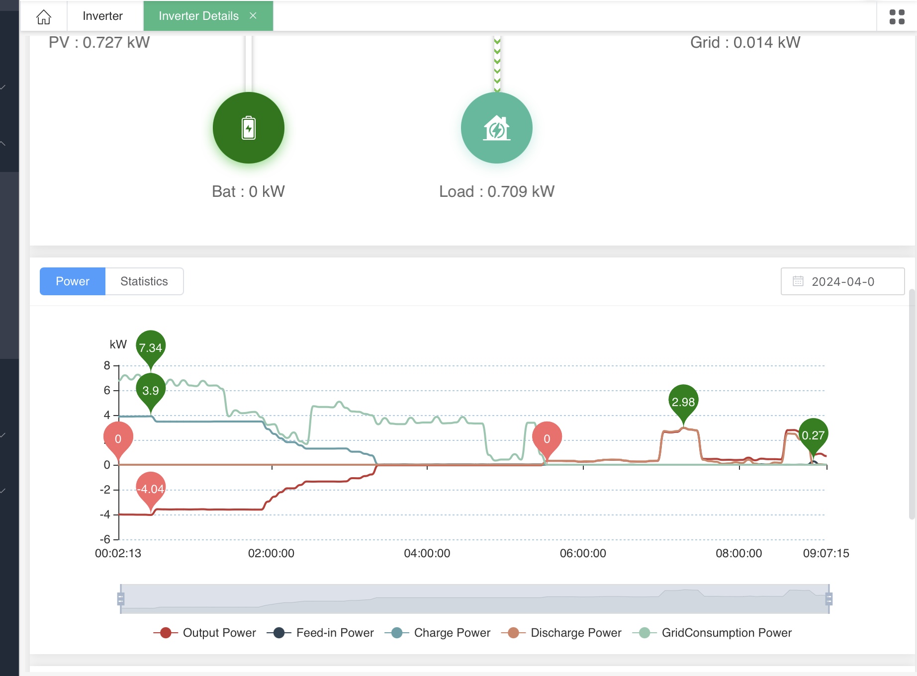

If you log into the Foxesscloud.com website - and go to the device page - on the graph at the bottom do you see any evidence of charge power (even if just small blips) - might be helpful if you post that here (the graph looks like the attached).
