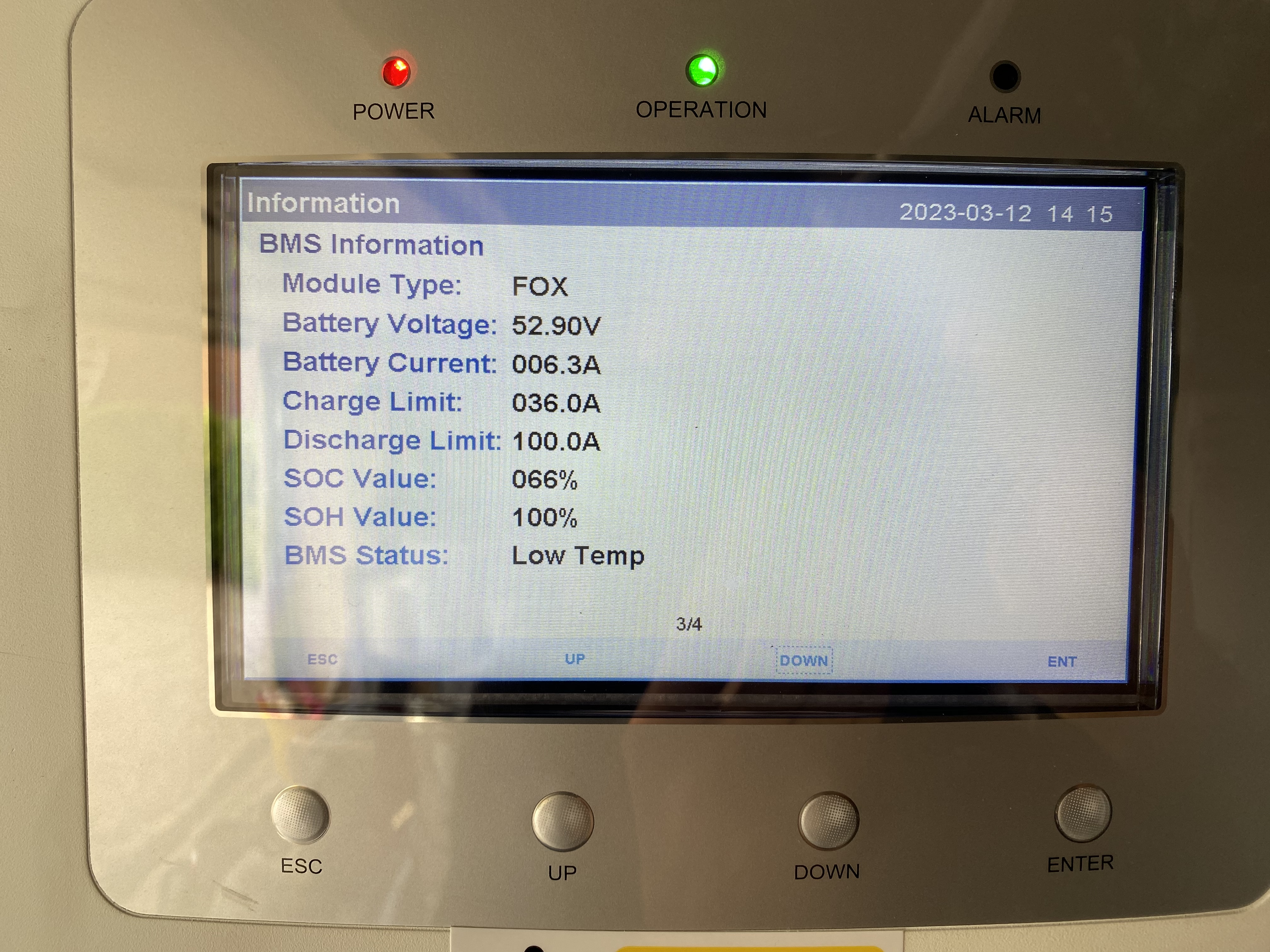

Interesting, I’m having a similar issue with low temperature charging, although the figures above don’t seem right as the LV5200 is rated up to 100A for charge and discharge.
My Solis inverter says the BMS is showing “status - low temp” and currently limiting the charge to 36A (about 1800W). I could understand that when it was 3 degrees C but today it is 13C and still says “status - low temp”!
That’s a big problem for me, I want my batteries fully charged overnight on my off peak tariff, I need close to 100A for that.

I had 3 engineers from Fox out today, so to be fair to them can’t complain about customer service! Unfortunately the charging behaviour is all by design though and no actual fault was found. Fox UK have had a number of complaints about this issue, I think the BMS setup is a bit over-cautious but whether they will change anything I don’t know, they will want to preserve their 10yr warranty. The latest firmware has been installed but I was told not to expect any different behaviour. At the moment the only answer is to keep them above a temp of about 15c or the charge rate will be ‘degraded’.
