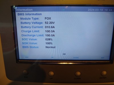

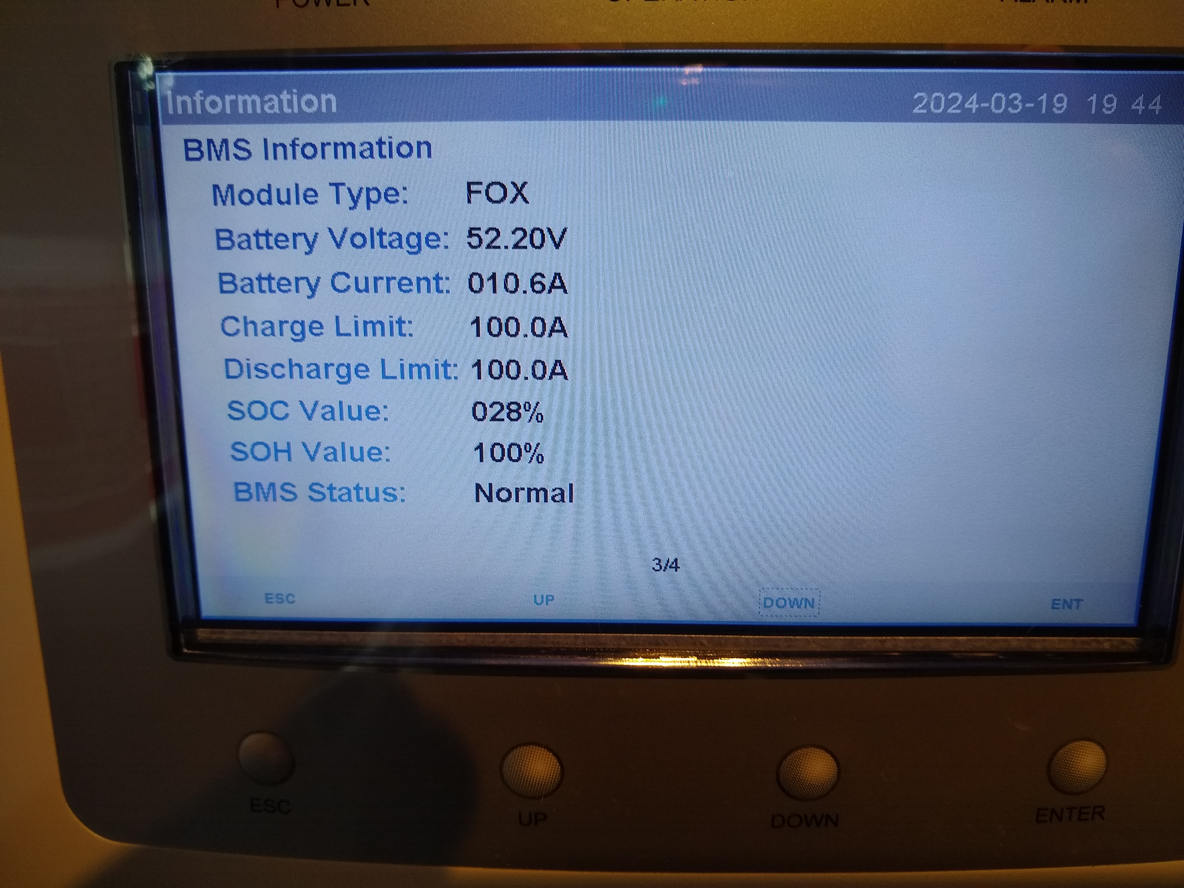

Good evening people, I am not sure if the settings on my 6kw solis hybrid are correct for my LV5200s. From what i can make out, the settings shown are default and should be higher because i have 2 batteries? I got lost fairly quickly when reading about this. Does the charge setting only refer to charging from grid? As you can probably tell, i have no idea about this! I have 12 x 405w panels. I have never got anywhere near 4kw, never mind 5kw, coming in from my panels. Even in the middle of summer on a really hot, bright day. Are these 2 things connected? If the charge amperage was set higher, would my batteries be charged quicker? Or isnt that how it works? I really wish i knew more about solar! lol!
I'm not that familiar with Solis inverters but from what I know those settings are correct for your batteries.
One of the problems with Solis 'LV' inverters is that they take low voltage batteries ('LV') which requires a very high current to meet the power demands of larger inverters for example - a 50V battery at 50A (a very high discharge current) = 2.5kW.
In you case with 2 LV5200's they are mounted in parallel which means you get a higher discharge current but at the same voltage - I don't know whether this is still true but the Solis hyrbid inverters using LV batteries were only able to discharge at a maximum power of 5Kw (100A * 50V) from the batteries. Obviously solar generation is different and they can provide the full power of the inverter if the panels are producing enough power.
It is one of the reasons that FoxESS use high voltage 'HV' batteries, and depending on which battery you choose the battery voltage is usually between 200V & 450V DC - (The EP5 for example is 200V DC) and this would mean that for a 6kW inverter full power can be provided by a battery discharging at 30A.
Also the reason why I wanted to make sure I mentioned this, is so you can double check the Solis battery discharge limitation is still 5kW as it wouldn't matter how many more LV batteries you fit if it can only discharge at 5kW - it would seem that the higher rated Solis inverters use HV batteries instead (but this would again involve you changing your batteries
