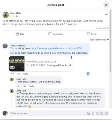

I can understand how you feel, i've copied this recent post from the Facebook group in case it's of interest to you.
Again probably not what you like to hear but the common advice is that as there is such a price premium for the older LV5200 batteries, it is better to buy the LV52 and sell your LV5200's on eBay (or the Facebook group) as you will still get very good money for a 15 month old LV5200.

Good afternoon Dave, I really dont know what to think anymore! lol! Every way of doing it has its own problems.I saw that the ep5 has a junction box for more than 1 battery. I may be able to find room for that to the left of my set up. Just a quick add up, going to be 6 grand ish whichever battery i choose. The cube looks attractive but i havent got the height space under the inverter and the KH is slightly longer. Thank you for the FB post but it is actually me! Well, its my partners account as i dont do FB. I am starting to think that buying another lv5200 is a waste. I am trying to keep obsolete batteries going by putting more money into them, which is a bit stupid when there are alternatives. Maybe you are right. Get a system that suits us and try and sell the old one somewhere. This is how its set up at the moment in a utility room i built. I guess i could rip out some of her cupboards! Yeah, that will make her real happy! Haha! Thanks again for the comment. I might start to actually understand my solar eventually!

Lol, I thought it was coincidence :)
