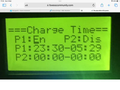

I have discovered that even tho the times for E7 had been set up, then hadn’t been enabled (EN) as they were sitting in DIS which I believe is disabled

Ahh ok, I didn’t want to send you off into the inverter settings until you had tried the app, but yes the charge period should be set to the time you want, and En means charge from grid.
It would look like this for charge period 1 set to 23:30 to 05:29 (charge from gird ‘En’abled)
