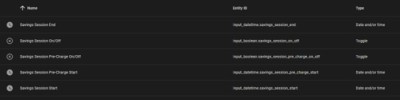

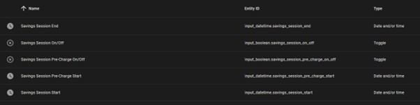

Next, you'll need 5 basic helpers to support the automation.
1) Main on/off toggle - toggle helper named "Savings Session On/Off"
2) Pre-charge on/off toggle - toggle helper named "Savings Session Pre-charge On/Off"
3) Pre-charge start time - datetime helper (set to time) named "Savings Session Pre-Charge Start"
4) Session start time - datetime helper (set to time) named "Savings Session Start"
5) Session end time - datetime helper (set to time) named "Savings Session End"

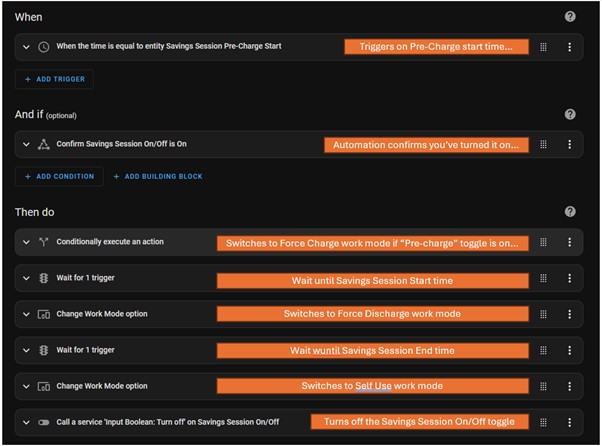

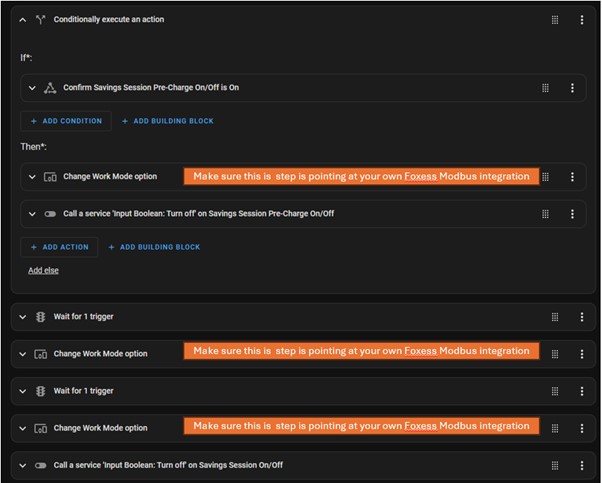

Next, you'll need to create a new automation.
Open a new blank automation, switch to YAML view and then copy and paste the code in the link below into the automation.
After you've copied the code - switch back to visual editor mode - then make sure work mode steps are pointing at your own Foxeess Modbus integration.

alias: Savings Session Automation
description: ""
trigger:
  - platform: time
    at: input_datetime.savings_session_pre_charge_start
condition:
  - condition: state
    entity_id: input_boolean.savings_session_on_off
    state: "on"
action:
  - if:
      - condition: state
        entity_id: input_boolean.savings_session_pre_charge_on_off
        state: "on"
    then:
      - device_id: 6be5bb4feedac189c5bf85cac8ea83f0
        domain: select
        entity_id: 42f2d324789f519b902c3aa15cbb5e32
        type: select_option
        option: Force Charge
      - service: input_boolean.turn_off
        data: {}
        target:
  - wait_for_trigger:
      - platform: time
        at: input_datetime.savings_session_start
    domain: select
    type: select_option
    option: Force Discharge
  - wait_for_trigger:
      - platform: time
        at: input_datetime.savings_session_end
    domain: select
    type: select_option
    option: Self Use
    target:
      entity_id:
        - input_boolean.savings_session_on_off
    data: {}
mode: single

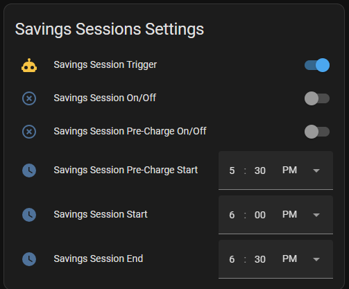

Once you've created and saved the automation - you can now create the card for your dashboard using the yaml code below.
Code: Select all
type: entities
entities:
  - entity: automation.savings_session_automation
  - entity: input_boolean.savings_session_on_off
  - entity: input_boolean.savings_session_pre_charge_on_off
  - entity: input_datetime.savings_session_pre_charge_start
  - entity: input_datetime.savings_session_start
  - entity: input_datetime.savings_session_end
title: Savings Sessions Settings
show_header_toggle: false
state_color: true

As mentioned, this automation is fairly basic but very easy to customise to your taste.
It switches back to Self Use at the end but you could easily edit the automation to have it switch to any other modes which suits you, for example.
