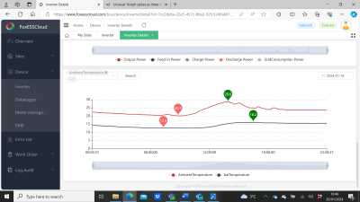

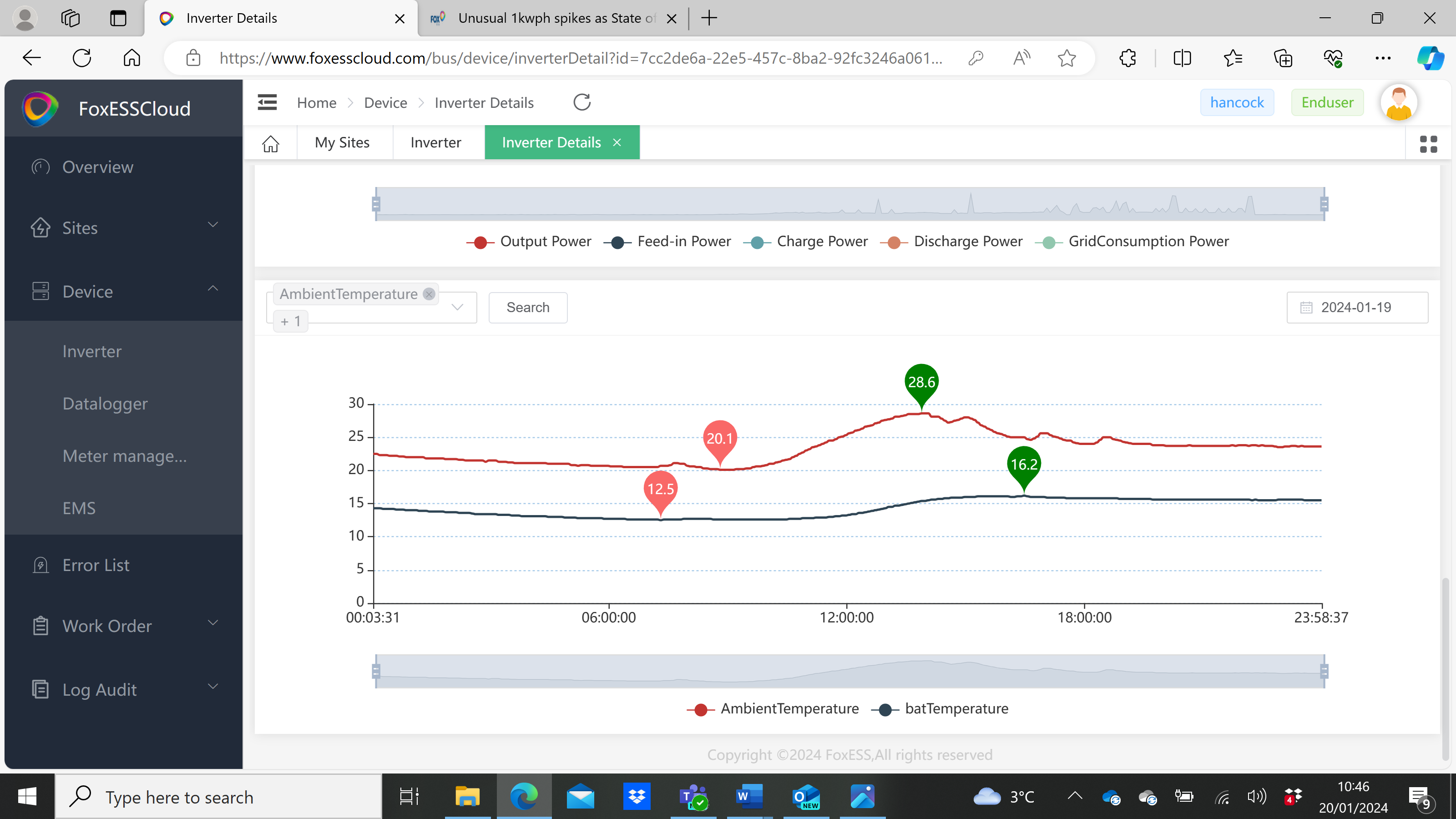

Hi. As attached (from yesterday) I'm seeing battery and ambient temp readings that seem way too high - batteries are in an unheated garage and currently I've got a thermometer showing 11.2 degrees ambient but Fox saying 27 degrees. I may live in Cornwall but we have not escaped the cold snap! Many thanks for any help here.

This is one of those confusing 'lost in translation' moments.
Ambient Temperature is actually the "inner temperature of the inverter" i.e. the heat measured near the CPU & DSP 'the electronics'
The InvTemp sensor is the temperature recorded on the cooilng fans at the back of the inverter, this will rise when it is working hard.
BatTemperature is the inner temperature of the BMS and as you see this increases dramatically when it is charging, the actual cell temperature of the batteries is usually around 6-10C lower than this shows.
There are actual battery temperatures reported (but as a user you can't access them) these show the battery cell lower and upper temperatures - They really should be shown in the app and there is an open request to add it to the new app which is in development.
