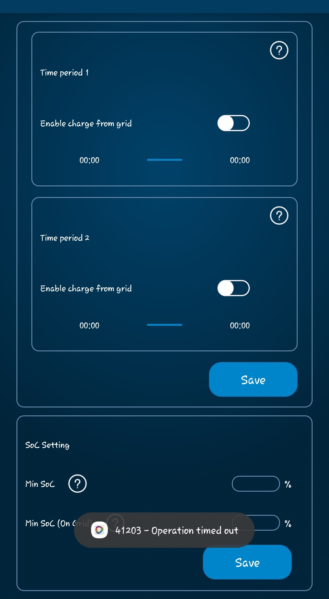

For the last few months I've been having issues with setting the Force charge via the android FoxCloud app, with the error "41203 - Operation times out" all other functions of the data logger look to be working OK.

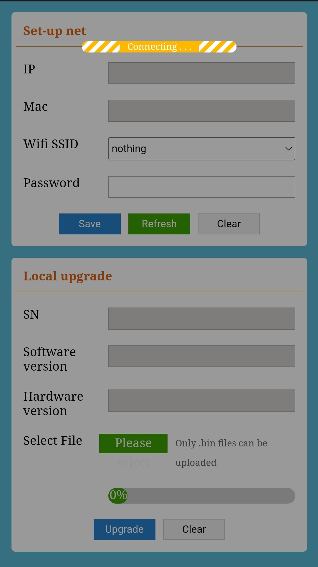

When I try to connect directly to the IP of the WiFi dongle, I can see the initial configuration screen, however it is now perpetually showing a "connecting" bar.

The timeout message you are getting is because the Foxess cloud has been having a lot of problems recently (just do a search through some of the more recent posts), it is being worked on and hopefully within a few days will be fully operational.
On the second point, you very likely don't need to bother re-connecting it - as it's the cloud with the problem, if the red light is flashing slowly with the occasional green pulse every 10-15 seconds it is connected fine.
The dongle screen you are seeing usually happens if the browser on the device you are using isn't compatible - usually on older devices, try with a newer phone, ipad, laptop - failing that un-screw the dongle, remove it and re-insert it and try again.

As for the Dongle web interface, I have disconnected, and reconnected. Using Android on a Glaxy Note 10 with Firefox and Google Chrome, alongside a Ubuntu laptop, running Firefox and Chrome all show the same infinite "Connecting..." issue. The main reason i wanted to access it was to prepare for changing over to a new WiFi SSID/Network name

Oddly up until yesterday (for nearly a week) I could not get the FoxEss Android app to let me change the force charge times, however after using the Energy Stats app to change the force charge time, I'm now able to use the FoxEss app again. Though with the nicer user interface of the "Energy Stats" app, and not needing to kick the user back to the login screen every day, will probably be my go to, at least until I can get Home Assistant connected to the inverter via RS485, and ditch this last piece of reliance on the "Cloud" (somebody else's server)jsfoxe wrote: ↑Mon Jan 08, 2024 11:41 am After any kind of glitch or reconfiguration, I find it can take half an hour or more for the wifi dongle to re-connect to the foxess cloud. Of course there's neither feedback nor control over this process, you just have to wait and hope.
