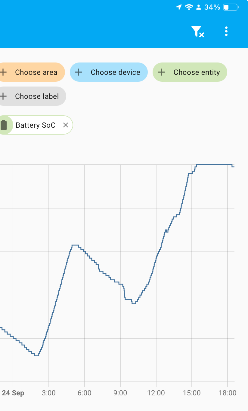

Hello folks,
I wonder if I can revive this thread please.
I'm having the same sort of problem — quick jump from circa 80% to max. I've gone through this thread, following the same steps — firmware was updated on Friday (thanks Martin at FoxESS UK!) and batteries are now 1.15 for the three v1s I have, and 1.12 for the two v2s.

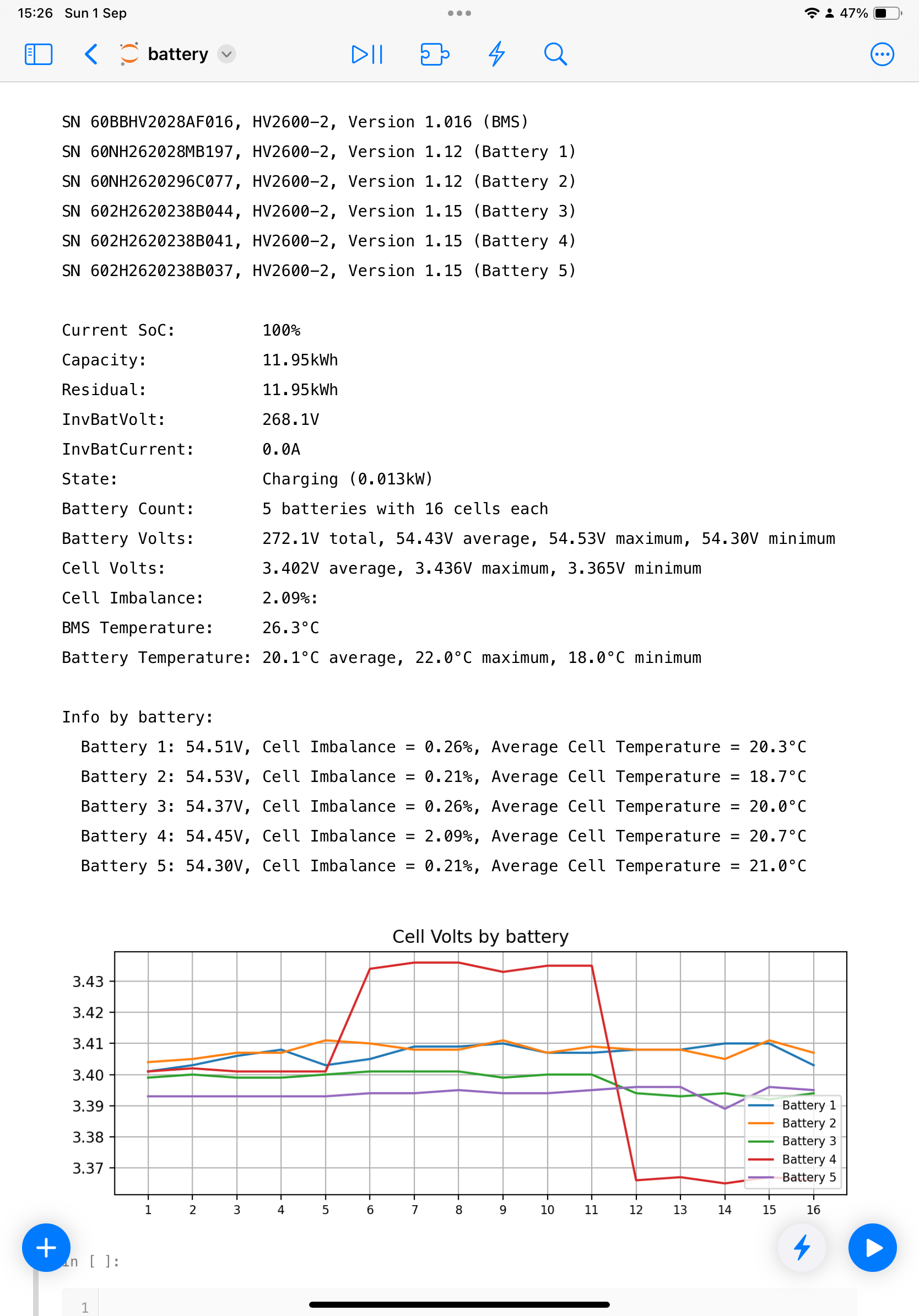

I ran the battery script in Jupyter too, and noted the attached. Is this suggesting battery 4 just needs to get its act together, and would separating v1s and v2s for discrete charge cycles help, or is it suggesting a deeper issue? I'd most appreciate an experienced view, and whether I just need to give it longer for some 10% to 100% cycles to balance things out with the new firmware.
Many thanks for any thoughts!

Battery 4 is out of balance, not specifically with the rest of the pack but inter-cell balance is not good - that could be the result of running on older firmware for a prolonged period and is most definitely what is causing your pack to jump at the 80% and likely to be causing it to drop near minSoC as well.
Usually you would expect to see a few cells low or high, but this pack is showing a bank of cells that are high, a bank of cells that are low and the rest are in-line with the other packs.
Breaking the pack is a lot of work, so first it would be a good idea to go with the easier option (which is very likely to correct it) and change your max charge current to 3A you can do that at the Inverter panel - Settings, Battery, Max Chg Cur.
That would mean your batteries will charge at 700-800 watts which will take some time to charge them but it will give them time for the cells to balance.
Make sure you take a full charge all the way to 100% and hold it there on charge for a couple of hours - that will help the inter-cell 'high' balance.
But before you do that you need to flatten the batteries, make sure your minSoC's are both 10% - use the batteries normally and let them drop to 10% (they may well overshoot the 10%) and wait for the BMS to cut power from the batteries - once it has, keep the pack at minSoC (don't charge) for at least a couple of hours - you will likely see the BMS do short maintenance charges (around 1000 watts) as it 'bottom balances' the pack - in effect what will be happening is the inter-cell 'low' balance will be correcting when this happens.
Once you have done a full cycle like this - then change the max charge current back to 35A and use the pack normally for a few days, if you could then re-run Tony's script as they approach 100%.

Fantastically detailed info Dave, many thanks for taking the time to write that! As luck would have it, it's tipping it down outside, I've just stuck the oven on, and the SoC has hit 10%.
I've dropped the charge rate to 3A via HomeAssistant, and disabled your helpful automation that was dropping it to 5A after 80% anyway.
Let's see how it goes. I shall update the thread in a few days' time!

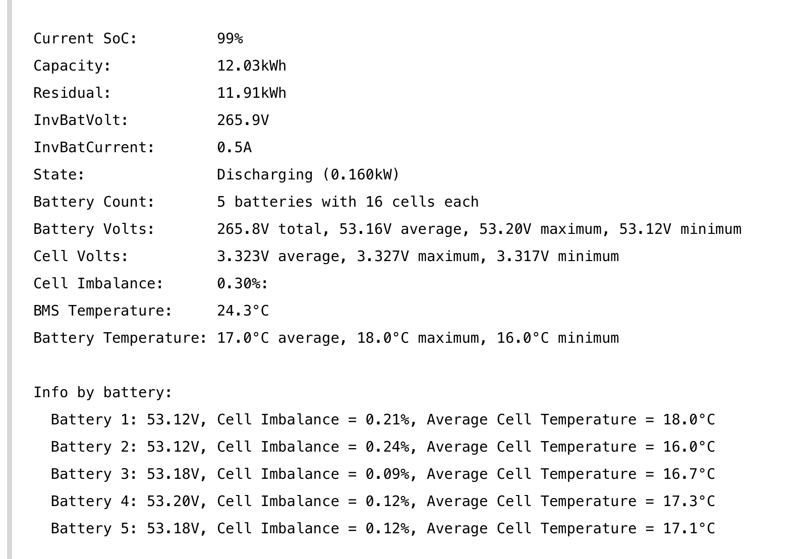

I think we're sorted! It's taken about 3 weeks to balance out, which matches what Martin at Fox support said.
Many thanks Dave for your help and guidance.
