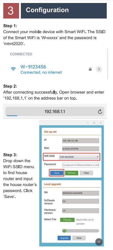

You need to connect firstly to the wifi dongles own wifi, the ssid is something like W-XXXXXXX once connected to that go to your browser and enter 192.168.1.1
I've found it a bit hit and miss on mobile devices as they don't like connecting to something that doesn't have internet and fall back to the nearest known internet wifi signal - if you are having trouble try with a different device phone / tablet.
The connection guide is at step 3 here -
