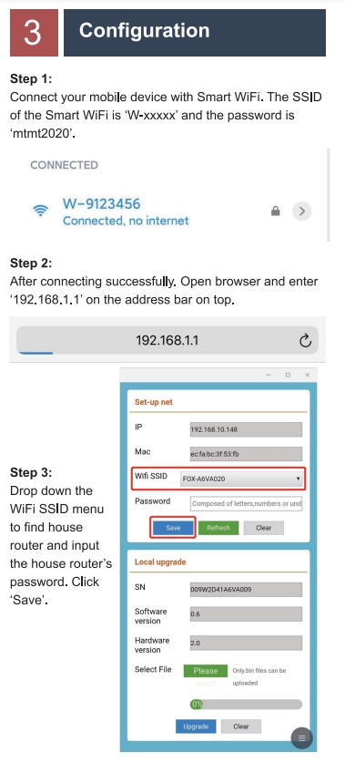

Hi, I have changed wifi router, how do i updated the wifi information for the invertor to send info to my phone app??
Re: wifi router change
The easiest approach is to change the SSID and password of your new router so that it is the same as the old one, then nothing in the house will need to change.
Or you can change the 'dongle' to connect to the new wifi, by following the guide below at step 3.
