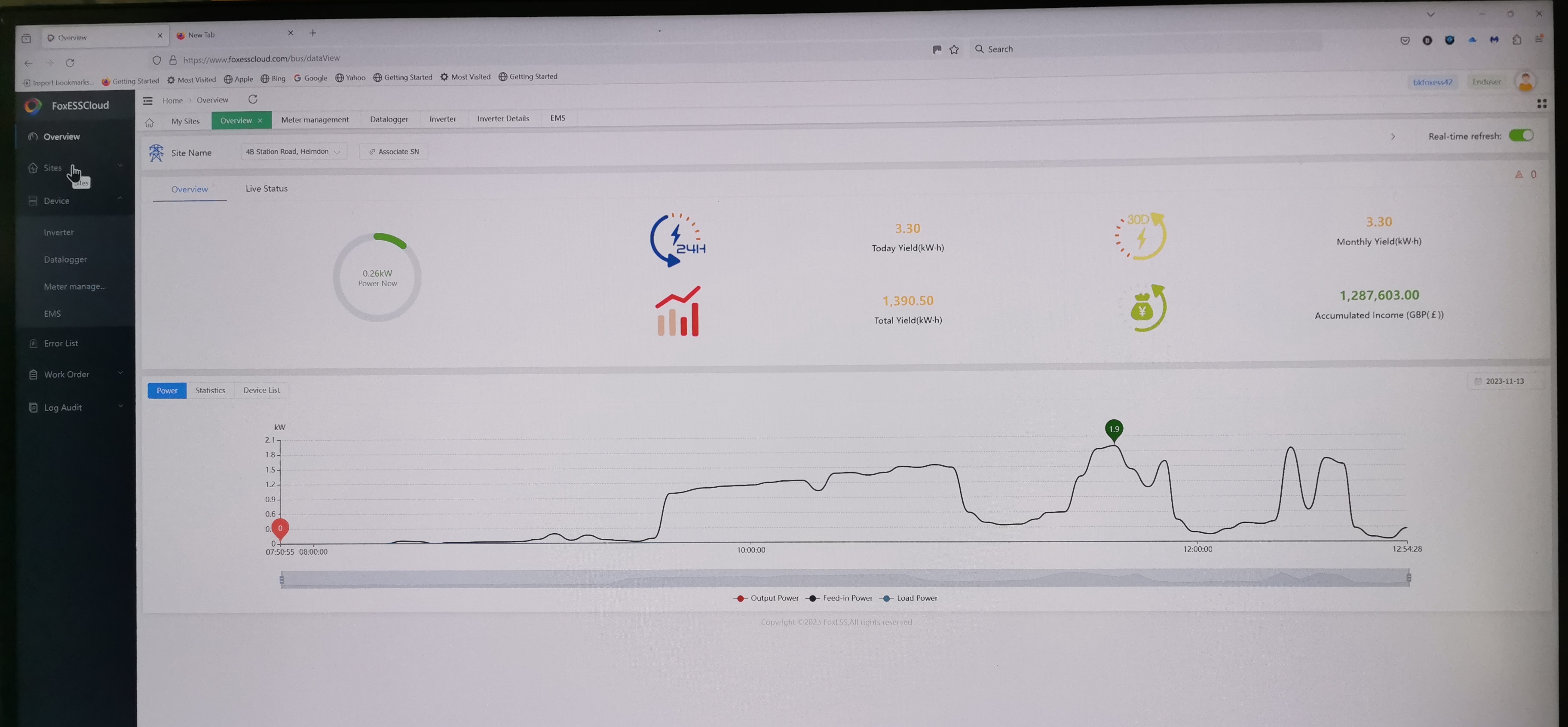

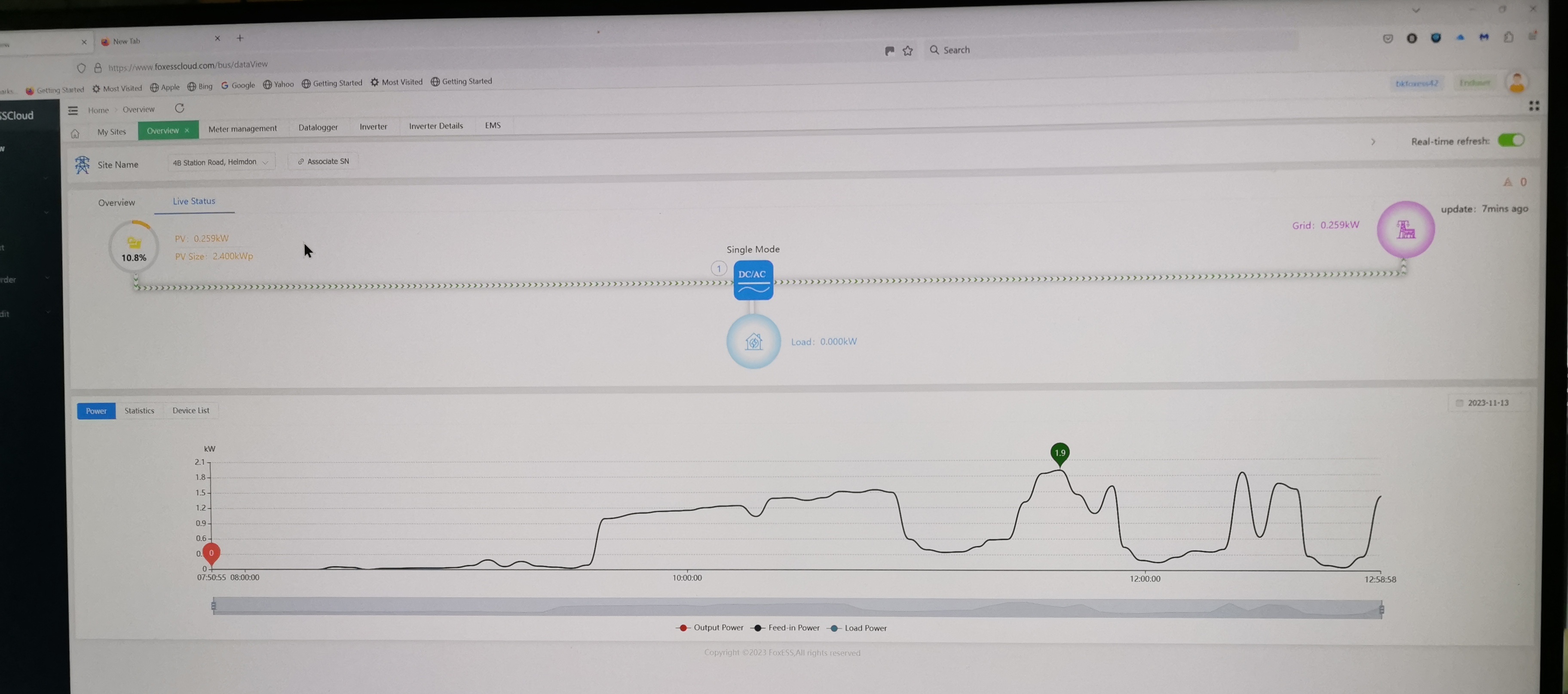

The Fox ESS Ap on my phone refuses to show any data despite the Wi-Fi connection to the datalogger working okay.
I managed to get a connection through my laptop and I get live data. Brilliant, so I thought, but I do not get the image of the battery: it's missing from the screen full of data.
So I can't stop the Grid from supplying power instead of the battery.

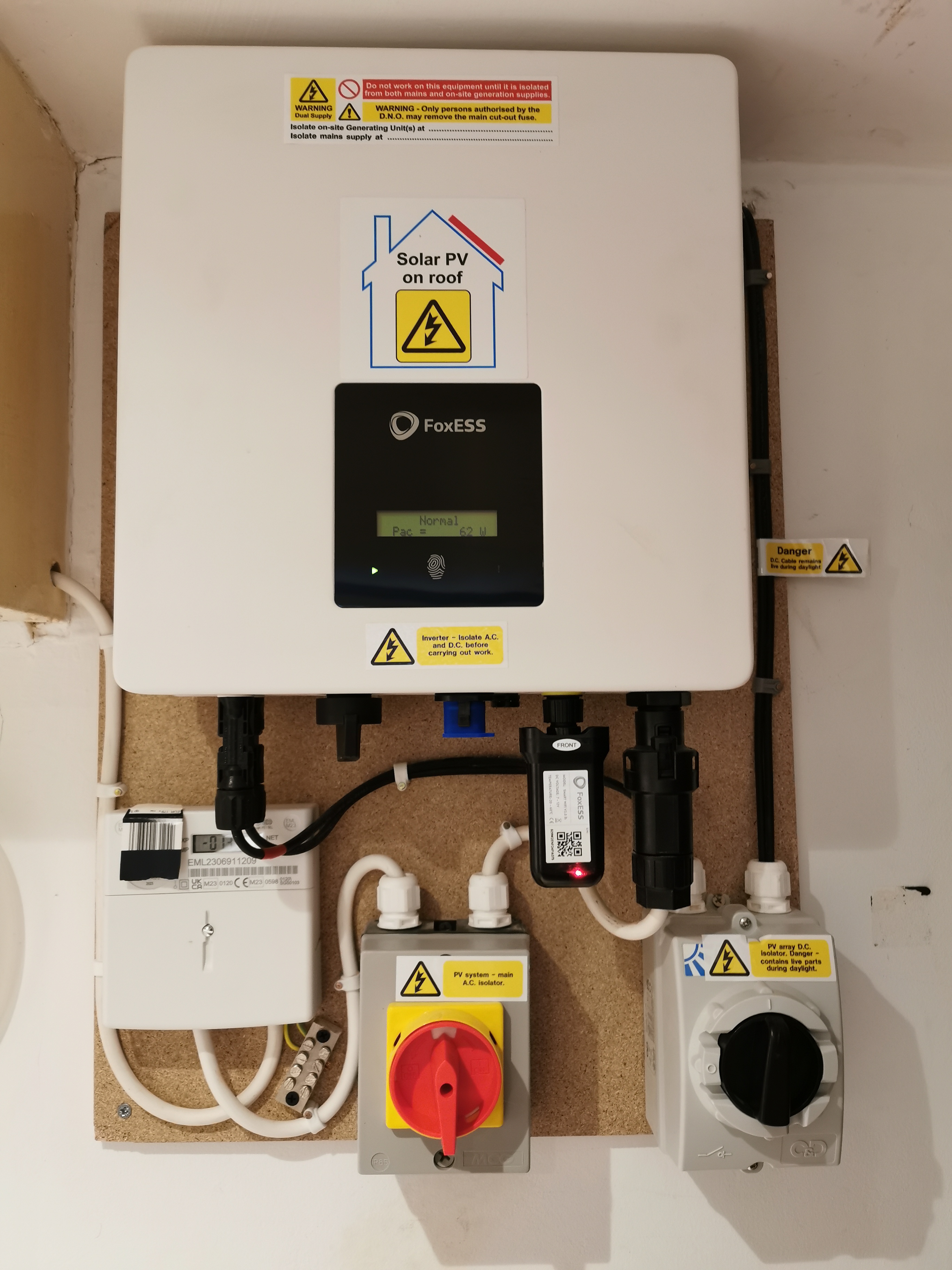

Ok, could do with going back to the beginning and working out exactly what you have installed.
You said you have an inverter and a battery - the battery is normally connected to the inverter, which inverter is it, an H1 hybrid, an older solar only inverter ?. And is your battery connected to another inverter or the same one
What batteries are they HV2600, Mira, ECS (Cube) etc.. - a few pictures would help to identify them

Inverter: S2500
http://foxesschttp://fhttp://foxesscomm ... 0217a819b8
Do you have a separate inverter that the batteries are connected to? The S2500 is a solar only inverter, it cannot be connected to batteries (at least not directly).

As Calum said there's no battery in there, it's a solar only inverter.
If there is enough solar, the inverter will provide power to feed the house during the day - it doesn't appear to have a very large array (2.4kwp) so large appliances like kettles (3kw) will still draw some power from the grid even on a sunny day but the vast majority of your house load will be being covered.
Those traces show you are feeding the unused power to the grid and you should be being paid for your export, but you have to apply to whoever supplies your energy (Octopus, EDF etc..) as they have to set you so they can read your export meter and give you an export tariff - if you haven't done that get onto it straight away as the power you are exporting is going to the grid for free until that is done.
