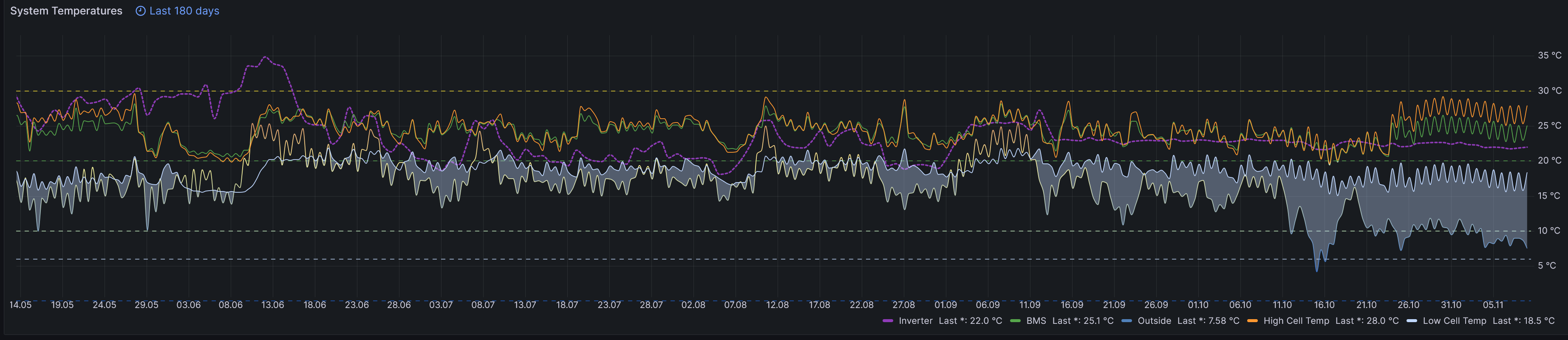

As an anecdote, we have our batteries in our garage, which is unheated, north facing and in the shade of the house. As a result it's always fairly cool and I've been able to leave my batteries in their insulated box (9mm OSB, lined with 50mm of EPS sheet) pretty much all year, I just prop the lid open in the warmer weather. I have Home Assistant connected to the BMS and giving me data on the highest and lowest temperatures the battery cells are at, so I can see in real time how the temps are changing as the system charges, discharges, etc, so I can be confident of how well they are being treated. For instance, I can see that over the summer the batteries have touched 30C at the high end when being charged by the panels, but otherwise they sit in the mid 20s.
If my batteries were in, for instance, a loft space they'd be a LOT warmer in the summer and I definitely wouldn't want to be leaving them insulated in that circumstance, if I was relying on passive cooling.
That said, if you were concerned about overheating you might decide to duct in cooler air from outside, in which case it might well be best to insulate the batteries from the high temperatures in the space they were in.
I have a feeling that the cold will still end up de-rating the batteries this winter as the lower packs will get a lot cooler than the upper ones, so I will probably look into some trace heating for the lower part of the enclosure, and possibly a fan to stir the air in there and equalise the temps a bit more.
