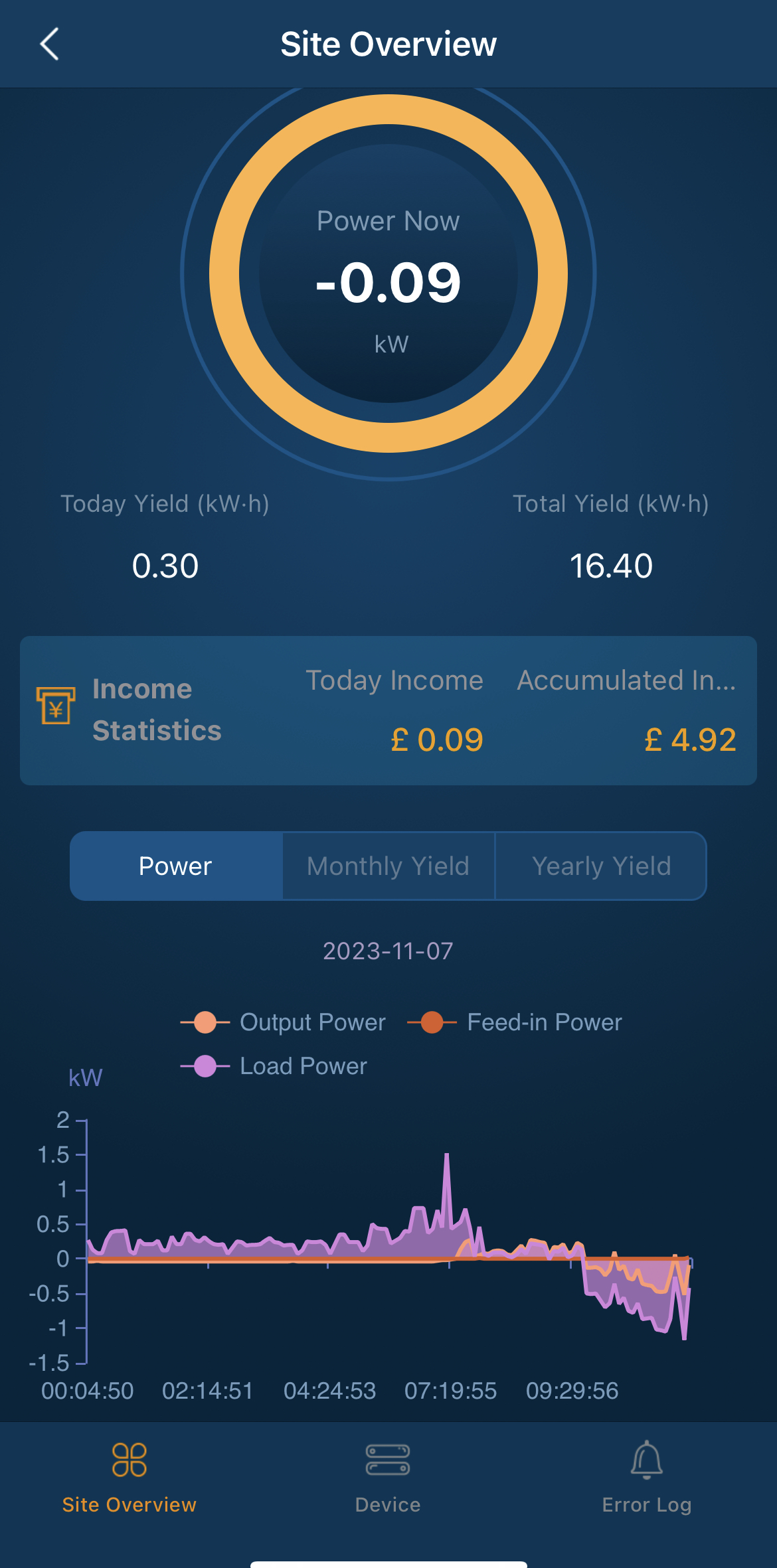

Ok, that makes a lot more sense, if you have a second inverter (S series), when that starts to generate power in the morning because the H1 is unaware of it, the H1 sees the load go negative and sees power being exported so it will charge it's batteries and that explains the trace you are seeing.
To balance the loads and run effectively you need to fit a second CT clamp to the H1 inverter wired into CT2 in the CT/Meter connector and enable it in the H1 settings - the CT clamp should be clipped/connected to the live feed of the S series inverter.
Once that is fitted, the H1 will know to deduct the generation from the S series inverter from the load and it will show the output of the second inverter in the Foxess app.
