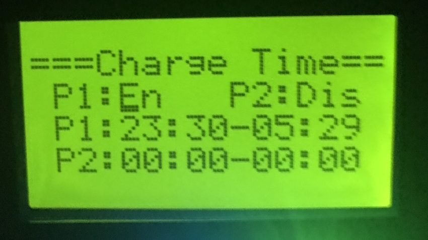

Your app only writes the settings to the inverter when you update them, thereafter you can close the app and the inverter will remember it's settings until you go back into the app and update them again. If the app is losing the settings, I would suggest you force close it and restart at which point it will re-read the settings from the inverter - if they are still blank it's more likely the cloud problem (timeout) you have mentioned which should be sorted soon.
One thing to add you can't use the battery charge settings if you have a strategy or schedule set as it will reset them each day when it runs (if you don't use the schedules ignore this)
If you have access to the Inverter front panel and want to check what it is doing, you can get to the charge times by clicking on Settings, Work Mode, Charge Time
It will show P1 & P2 charge times (00:00) if not set, and will say 'En' for enable if you have one set to charge from grid, or 'Dis' if you have no grid charge set
(see attached, this shows charge period 1 is set to grid charge from 23:30 to 05:29, period 2 not set)
