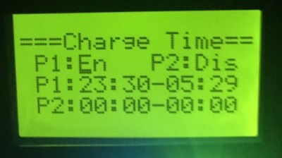

If you have access to the Inverter front panel and want to check what it is doing, you can get to the charge times by clicking on Settings, Work Mode, Charge Time
It will show P1 & P2 charge times (00:00) if not set, and will say 'En' for enable if you have one set to charge from grid, or 'Dis' if you have no grid charge set
(see attached, this shows charge period 1 is set to grid charge from 23:30 to 05:29, period 2 not set)
