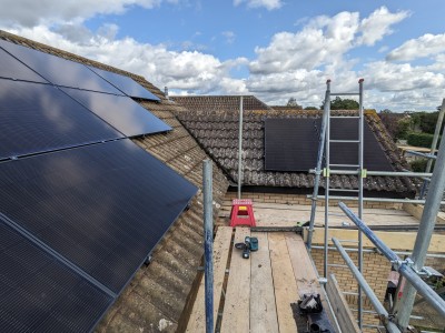

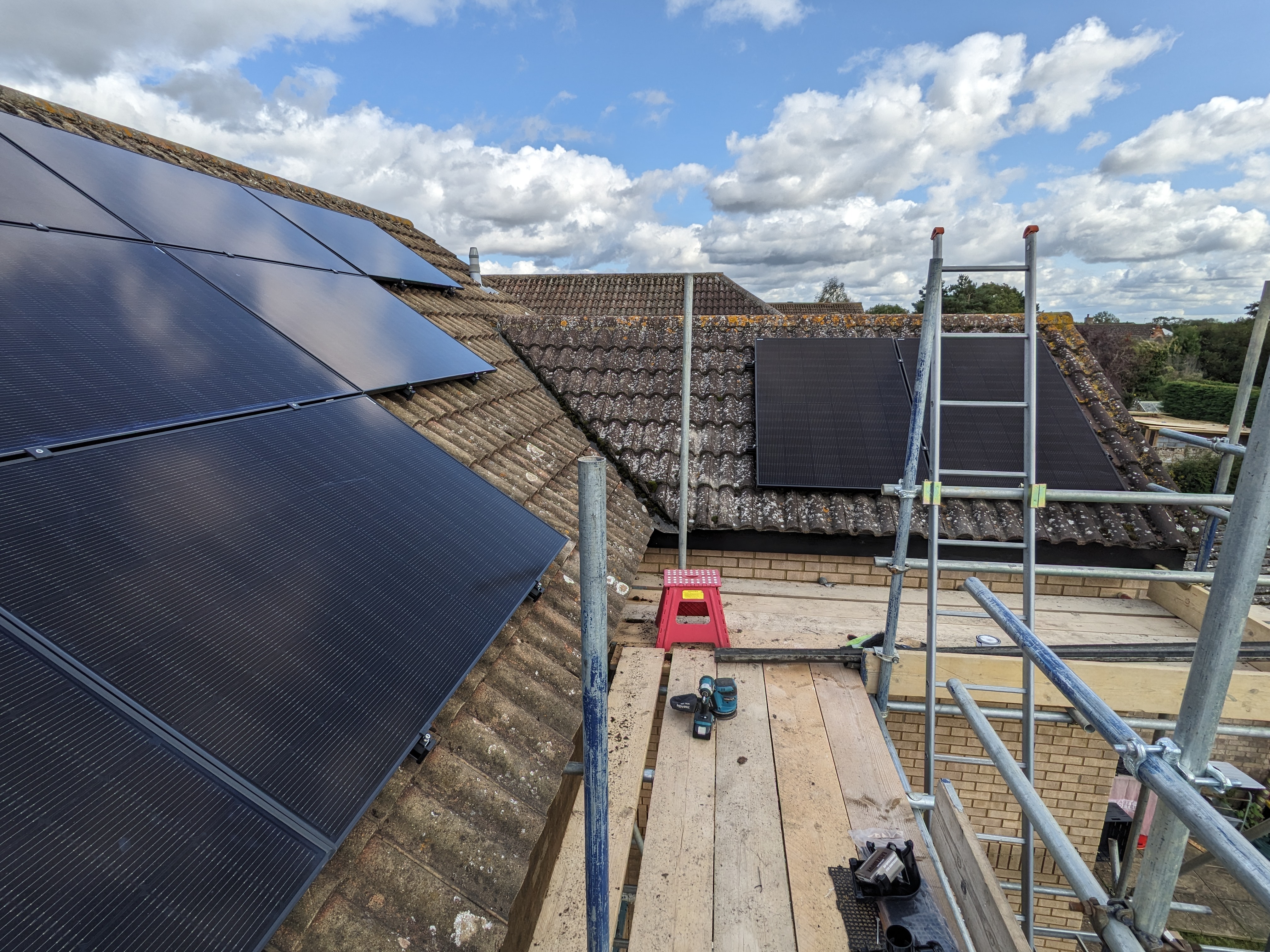

I don't have the space to add more panels on this second string so was hoping I could just get panels that have a higher Vmpp. This is the current setup. Not sure what I can do now. 🤔

Hmm, just a thought, but you could add the 2 panels to your 9 panels, they're not going to get the same sunlight so you will need to put Tigo TS4-A-O optimisers on the 2 panels that are on there own, that way when they are out of the sun they will not reduce the output of the other 9.
