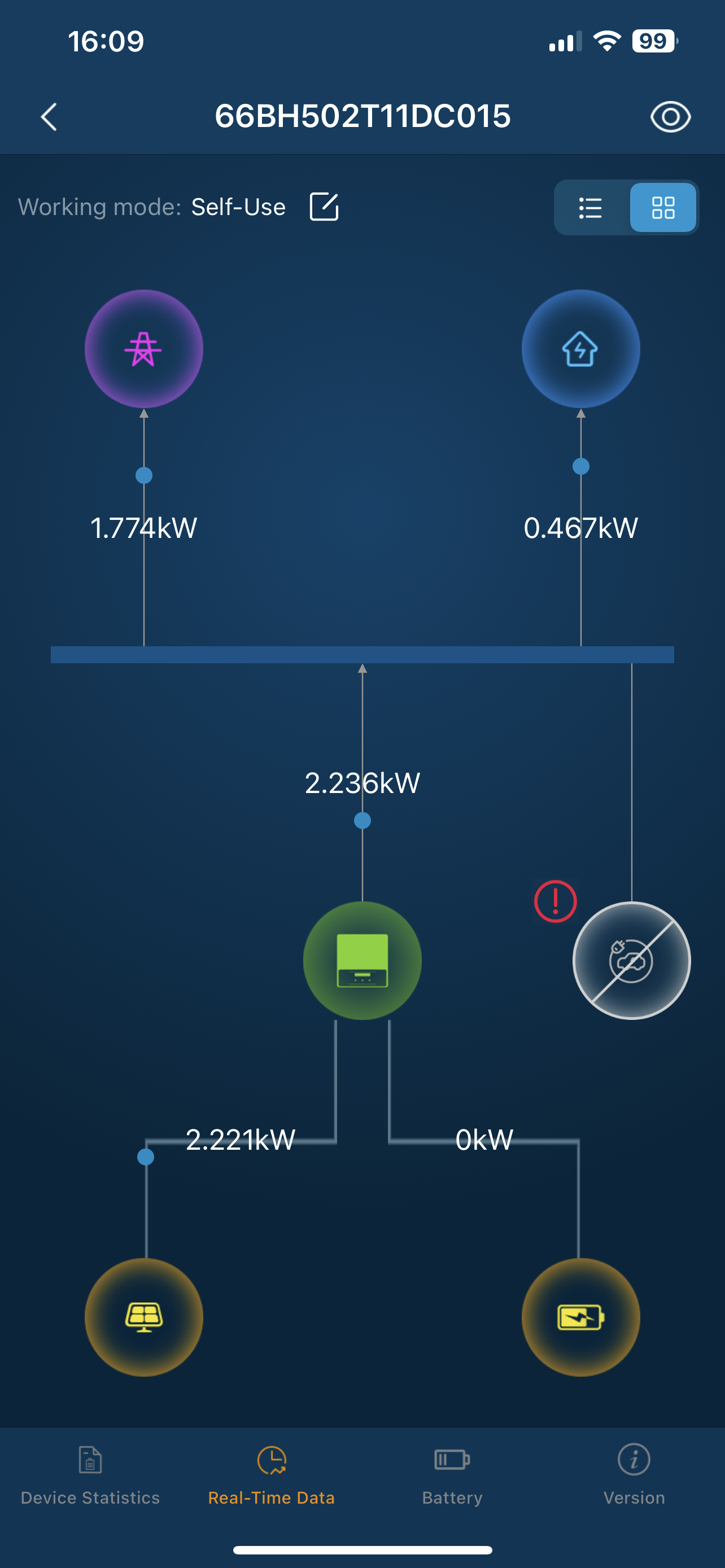

I noticed during the week that I was generating 2.2Kw from my panels, we were using 0.4 and the rest was being sold to the grid.
I want it to charge the battery at all times and only sell to the grid when the battery is full.
Obviously in the evening I’m buying back what I’ve sent to the grid at the standard tariff

Hi there, what work mode is your inverter set to?

It is set to self use.

What does the device statistics look like for that day? The problem with the app is it only takes a snapshot every five minutes. If your inverter was just providing say, 2kW and then that load finishes, for an instant it will be providing power that is not needed and you see a spike going to the grid.
