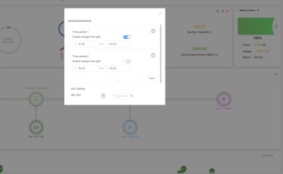

does anyone know why I don't have "Force charge from grid" option. I only have "enable charge from grid"

If you set the start and end time to 00:00, you disable that charge period altogether. If you set a start and end time, but don't set the "enable charge" switch, the battery won't discharge during that time, but it won't charge from the grid, either. If you set start and end times and enable the switch, it will charge from the grid in that time period.
