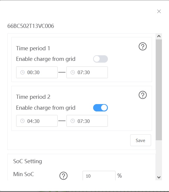

What do you have set for the charging time periods?
Mine are set like this: What came as a surprise to me recently is that the top entry values mean there will be no discharge from the battery from 00:30 to 07:30.
It's a useful feature to avoid using charge from the battery during a cheap tariff period.
Graham
Graham
