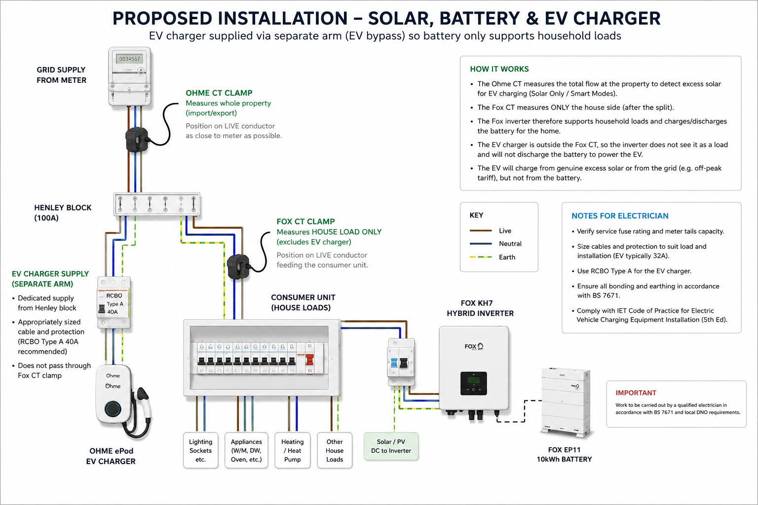

My Ohme ePod is draining my solar battery, and despite logic within Home Assistant to try and prevent this, I'm struggling.
I found this recommendation
at https://fox-ess.tech/community/main-for ... hatgpt.com
But why does it require/suggest two Henley blocks?
I'm trying to enable my EV Charger to function using Solar benefits (excess export etc), but not drain the house battery. A common task, asked in 11897 different ways, I know and appreciate.
I have Solar, with Fox 7kW HYBRID inverter and Fox EP11 10kWh battery.
Fox 7kW HYBRID inverter with Fox EP11 10kWh battery

But back to your question, you would expect every single phase hybrid to have the first henley block where the inverter and house load are connected, that is usually just after the live feed from the smart meter.
To have the EV charger ‘upstream’ of the inverter / house load so that it is not seen by the inverter you need to fit another henley block between the first and second henley blocks and the EV charger splits off there. That way the EV charger is in front of the inverter/house and it will not discharge your home battery, but the EV charger will be able to see any excess solar and use it.

But from what you have said if your objective is to power the house from solar/batteries and the EV only from grid import/solar the only option for that is to move the EV charger connection in front of the inverter/house load as per your original diagram.

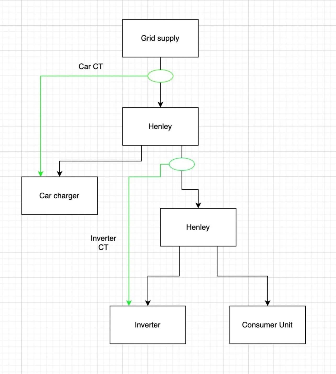

This’ll do it… yeah?

The only grey area there is where the inverter isolator joins the consumer unit, the ideal approach is as your first drawing i.e the consumer unit feed would be split before the consumer unit and the inverter connected there.
The issue with inverters being connected within a consumer unit is that depending on how it is wired, you can have voltages present on the busbar and the house circuits even when the consumer unit isolator is open.
Clearly there would need to be ‘Dual Supply’ Solar PV labels that warn that both supplies have to be isolated before any work is carried out but a significant risk exists.
