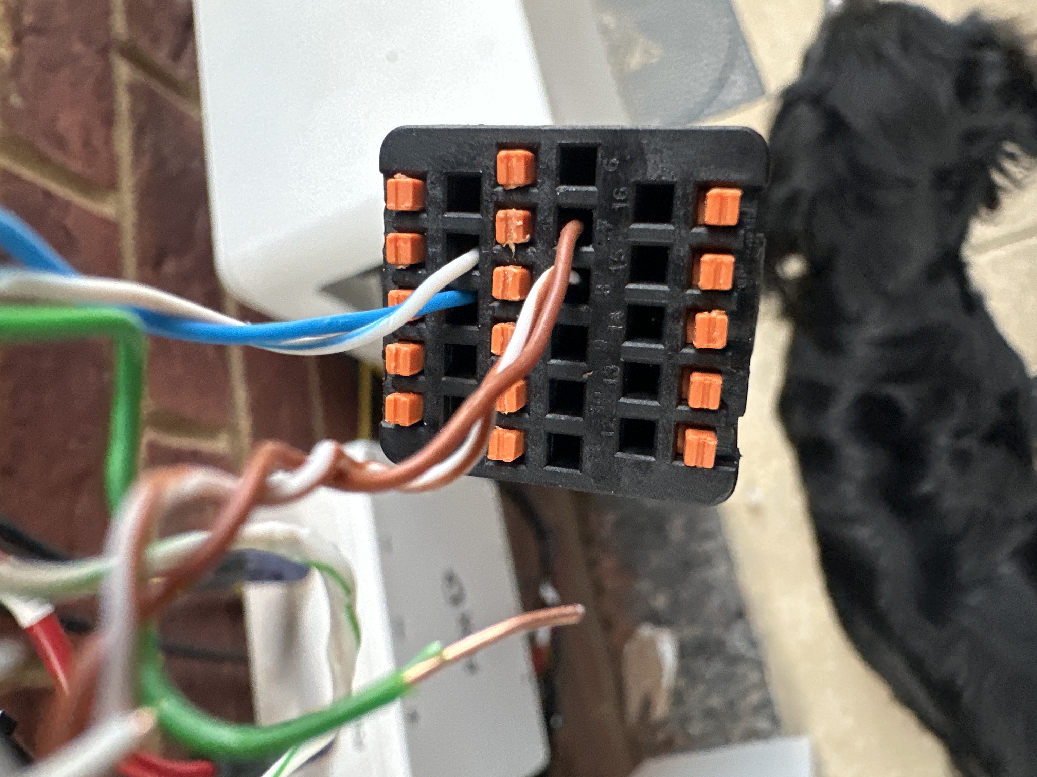

Hi all, I’ve been attempting to get my kh9 hooked up to home assistant and managed to bodge my CT clamp connector at the same time.
I’ve put the CT in 7-8 and the other wire into 3/4 without much luck.
Any ideas?
The home assistant (RS485) wires should go into 3 & 4
The main CT (CT1) should go into pins 7 & 8
Your picture looks correct so far.
I'm not clear what the other wires are unless you have a second CT clamp fitted>, in which case they should be connected to pins 5 & 6.
Thanks for the reply! They were all correct but the CT was using both wires blue/brown so I corrected that this morning and it is now working as expected.
I had split the brown and white. Ignored the blue. So got them both in and I’m up and running again (now with home assistant)
