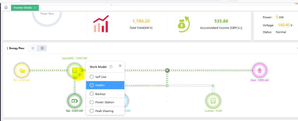

Hi Mark,
The work mode can be set laboriously on the inverter panel - see Will's good Youtube presentation on all the settings.
I use the web-based access to the cloud server and it is easy, once you find an odd little blue icon on the bottom right of the Inverter mimic in the Energy Flow diagram. The cursor switches to a finger if you hover over it and it opens the work mode menu (though some options are not yet possible/implemented)
I have highlighted the specific bit on this image, which I hope helps.
Alan
Alan
