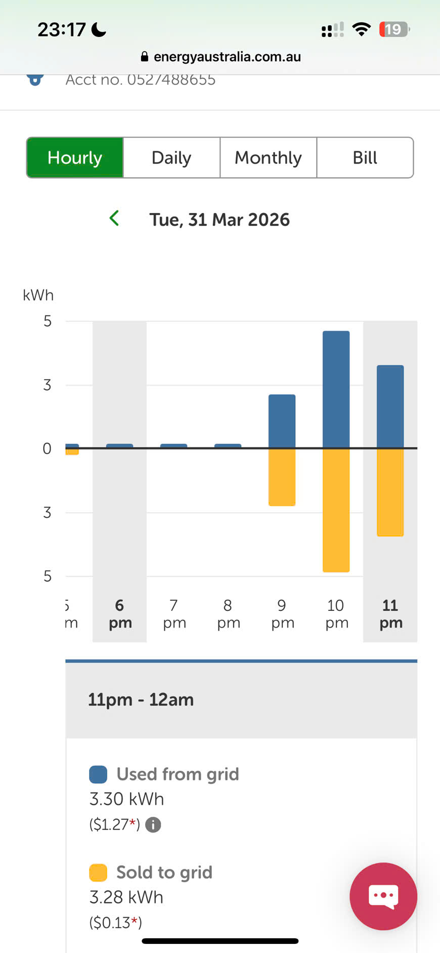

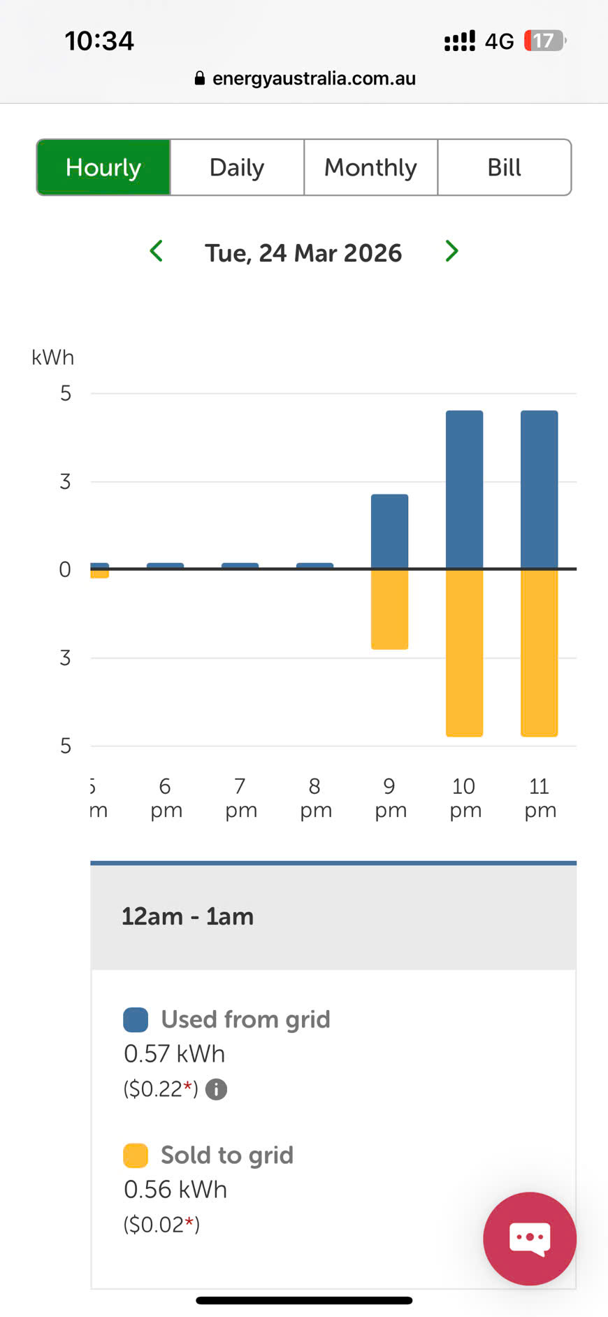

After installation, I found that my solar sold to the grid and was purchased back at the same time. The smart meter shows as follows
It seems each time, energy is discharged from the battery, sold to the grid, and purchased back for use.
I asked the installer, but he said no issue on his side, but I suspected something was wrong here, even the inverter said pull from the grid a small amount.

Thank you, Mark, for your response. I found the problem:
- My hot water heater is on control load 1, and when it runs, the inverter detects that the house is using energy and discharges the battery, and sells the electricity to the grid.
- At the same time, the hot water draws electricity from the control load 1.
