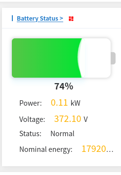

After much back and forth with Foxess Helpdesk, Alex persevered and did a great job, there is a way around this issue.
Firstly disable the Work Scheduler in the app - Go to the app - Click on Work Mode - Click on Blue Opposing Arrows in top right corner - select Self Use. This turns off Work Scheduler in the app and prevents the 44096 error when setting the Forced Charge in the Desktop website.
- Using Version 1 Desktop foxesscloud.com go into your Inverter Details screen
- Click on the Red Bubbles to the right of Battery Status
Screenshot from 2026-05-06 09-51-09.png (19.25 KiB) Viewed 42995 times
- A window will open to set your times for a Forced Charge
- Set your times
- Enable or disable charge from Grid
- Save
These settings will not appear in your app
If you get a 44096 error its because your Work Scheduler in the app is still enabled or basically not set to Self Use
This is far from ideal and who knows when V1 of the website will be pulled but works for now I guess.
