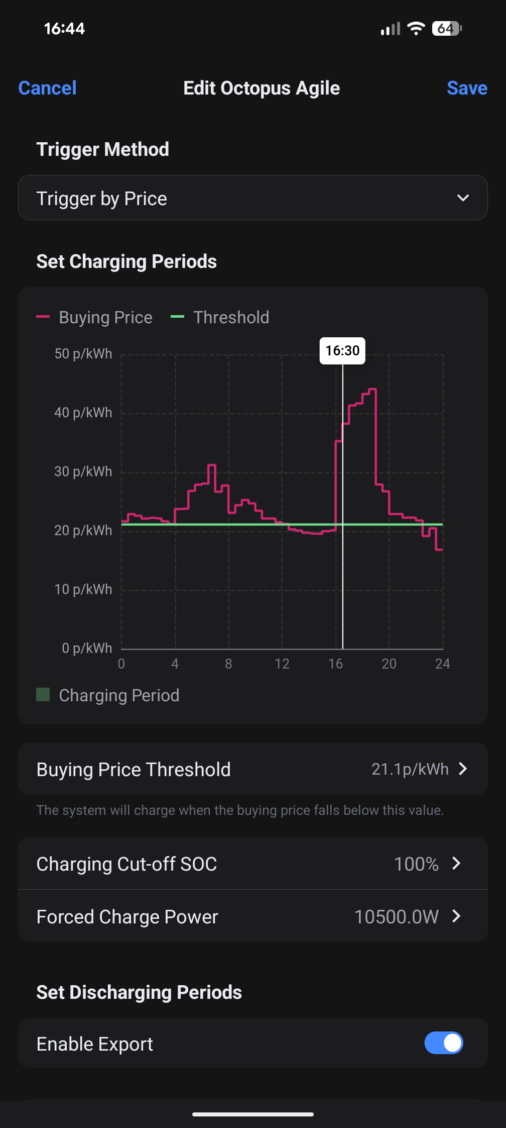

Hi all, pretty new to all this and Im letting the fox cloud app work it out for me.
I'm on octopus agile with an export tariff as well.
I've just been green lit to export onto the grid. Octopus have said I've sold some to the grid, but my fox app doesn't show any export.

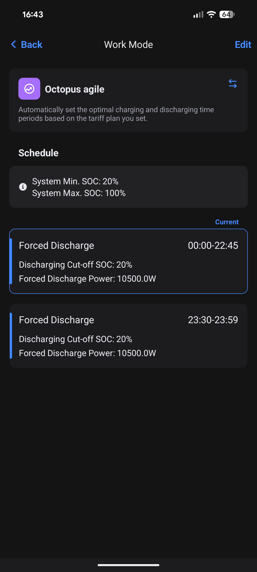

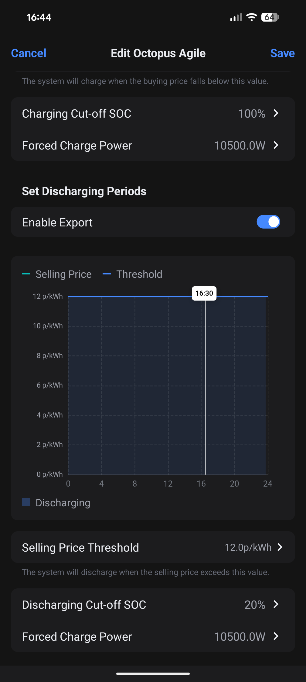

I thought deleting my tariff and redoing my API key may help.
Since doing this, my battery doesn't charge unless I turn off enable export. It's been sat on force discharge for the last few days.
Any help would be massively appreciated.
I've attached screen shots of all the settings to help any one trouble shoot that is far more technical than me!
