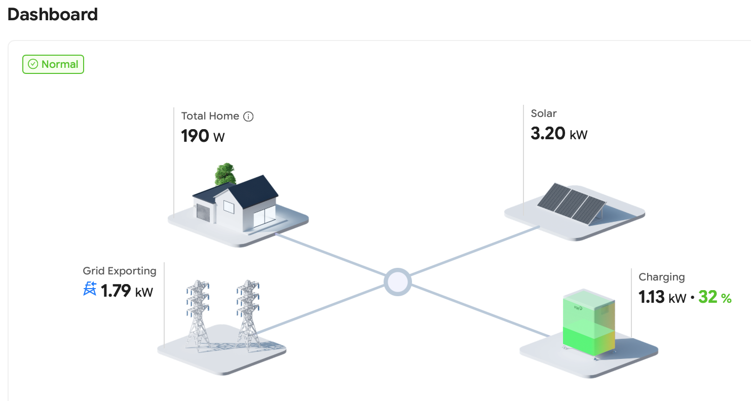

Why is my battery discharging to the grid when the SoC is only 32%?
Panels are generating 3.2kW but 1.79kW are being exported to the grid?

Morning,
The image shown is a snapshot of a point in time, like a picture. So the values shown could have been temporary, and the next 5 minute refresh of the data it could have stopped exporting.
That being said, it maybe your battery is a little cold and cannot take the full charge speed, more so if it fitted externally.
Can you find out your temperature of your battery and report back.

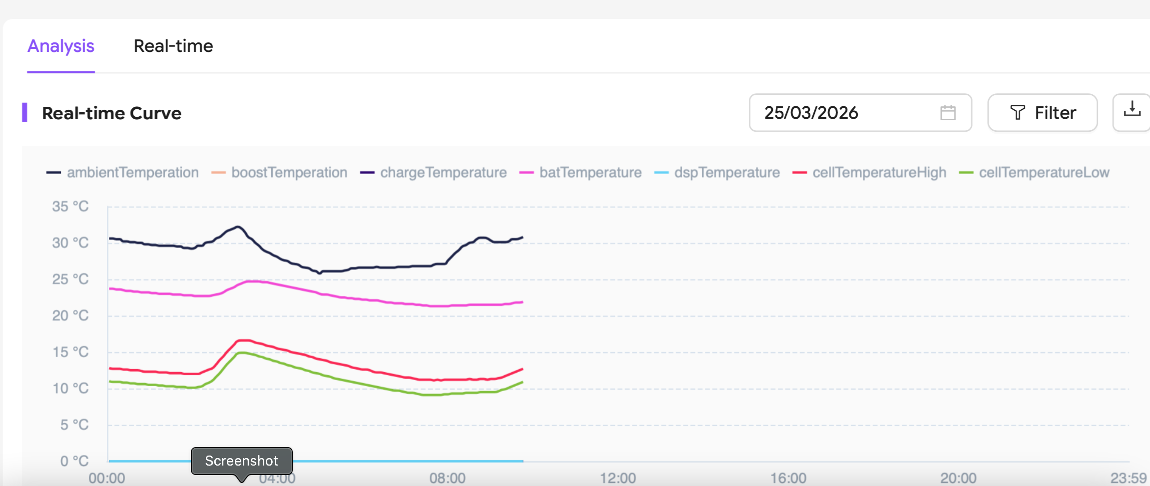

Hi, I have put together the chart below, not sure which line is the most important

The green cellTemperatureLow controls your charge/discharge rates.
There is a chart here in the video at 5m 30s
Has your charging/export changed now a few minutes has passed?

Today isn't the best day for checking this, but I can say for certain that it won't charge the best at the low temperature it currently is sat at.
There are some settings you can check on your inverter screen if needed, that will also be in Will's video collection.
Worth checking a few out, and his "Shorts" video section
