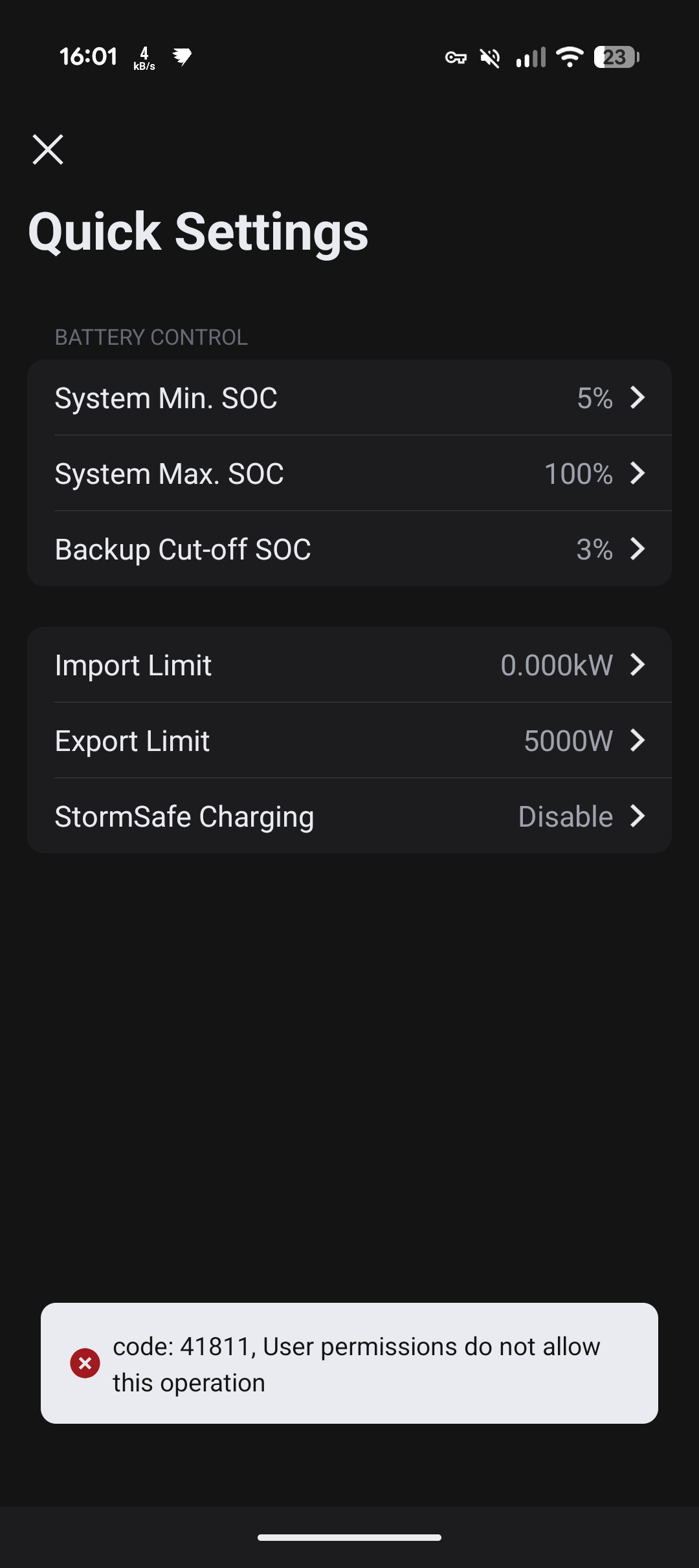

Hi guys,
I am currently using the up-to-date FoxCloud 2.0 app. Up until this morning, when I tried to change the Quick Settings under "Export Limit" & "Import Limit:, I suddenly encountered the below error message:
code: 41811 user permissions do not allow this operation
Given that error my system's current battery export is capped at 5kwh... even the value in the scheduler is above this figure.
I always use the same account to login and nothing has change but suddenly lost ability to manage my devices... I have submitted a support ticket through Fox's official website. In the meanwhile, has anyone got a solution to this?
Fox ESS has been making lots of server changes + forcing firmware upgrades on inverters/batteries.shmzhu wrote: ↑Sat Mar 07, 2026 6:46 am I am currently using the up-to-date FoxCloud 2.0 app. Up until this morning, when I tried to change the Quick Settings under "Export Limit" & "Import Limit:, I suddenly encountered the below error message:

I noticed the similar issue since morning! have also created a support ticket.
I managed to find a workaround by using a third party app called Energy Stats and regained the access to all previous settings from there. Hope it helps!ajeetsingh wrote: ↑Sun Mar 08, 2026 5:46 am I noticed the similar issue since morning! have also created a support ticket.![]()
It is good you found a work around via 3rd party app.
For anyone else following, End User access accounts are blocked from making changes to certain values, hence the message seen.
But why "Quick Settings" => Import & Export Limits, that was very much needed functionality. That was so handy and now I am stuck the way I used to use was set a scheduler to max values and limit it quickly from Quick Settings so no messy thing. But now I am stuck cos previously I set my Import Limit to ZERO now, when I even do the force charging with Allowing Grid Import it is not importing anything from Grid cos my Import Value in Quick setting was ZERO.MaterialBarracuda48 wrote: ↑Sun Mar 08, 2026 11:26 amIt is good you found a work around via 3rd party app.

That's due to schedules being set, not end users not allowed to do something.ajeetsingh wrote: ↑Mon Mar 09, 2026 12:52 am But why "Quick Settings" => Import & Export Limits, that was very much needed functionality. That was so handy and
See here https://foxess.evilbunny.org/doku.php?id=knownissues
