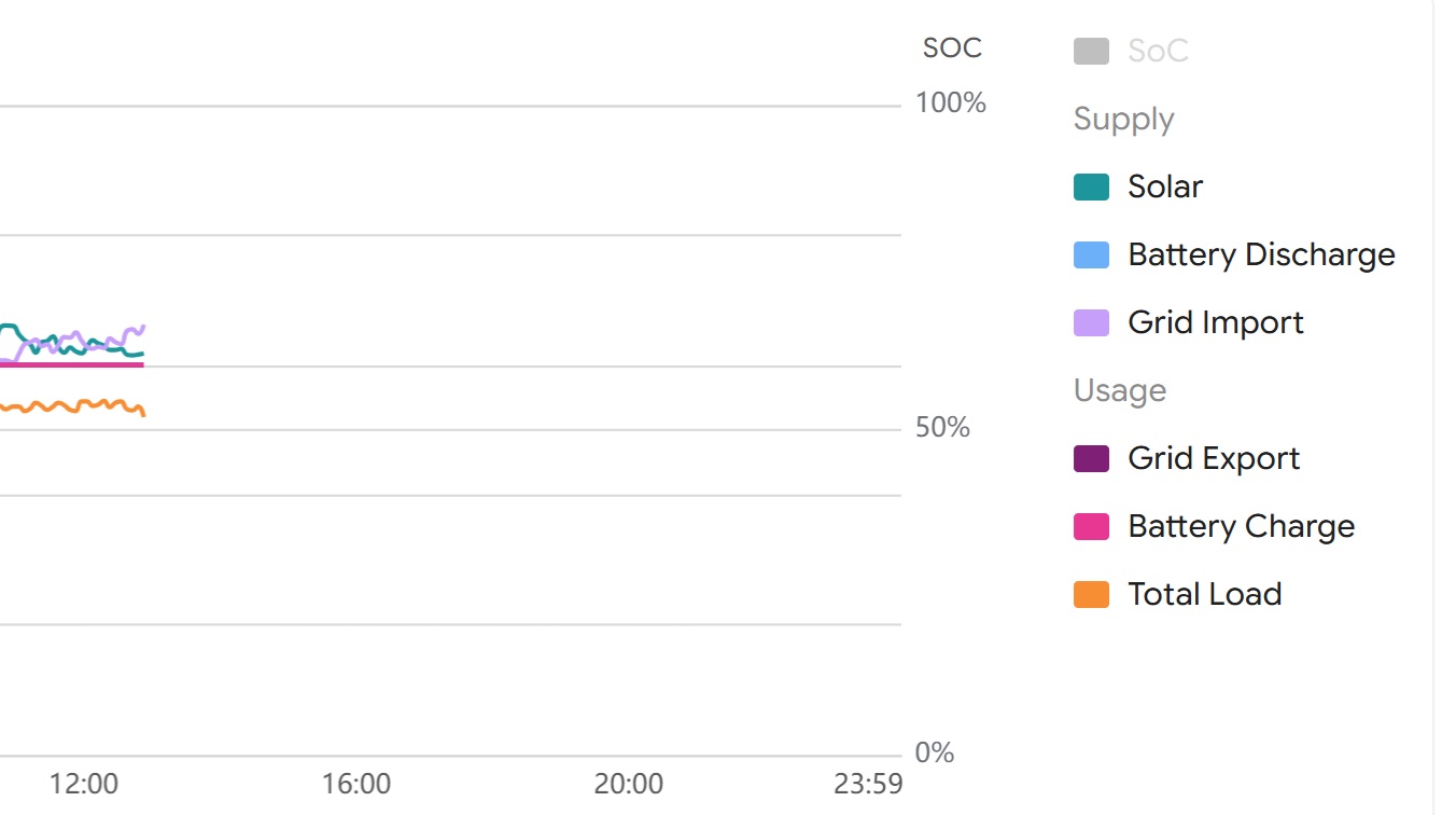

I'm getting my head around the API and have so far been using the following endpoint paths:
Code: Select all
/op/v0/device/real/query
/op/v0/device/report/query
I notice today, the FoxESS cloud UI has started showing a different set of metrics [see attached]
Is there any information that tells me how those items in the legend map to the variables for the payload when making an API call?

I've switched to the history API call because it actually gives me the granularity I was looking for. I'm still struggling to map the variable names though. Currently using this:
"batChargePower", "batDischargePower", "gridConsumptionPower", "feedinPower", "generationPower", "loadsPower", "SoC"
these don't seem quite to correspond with the figures I see on the FoxESS UI - discharge value doesn't relate.
Do you know if there is a * option for variables? If I make a request for all of them, I can probably deduce which ones relate to the numbers I am seeing in the UI. (The values will obviously be slightly different between real time in the UI and history in the 5 minute log)
