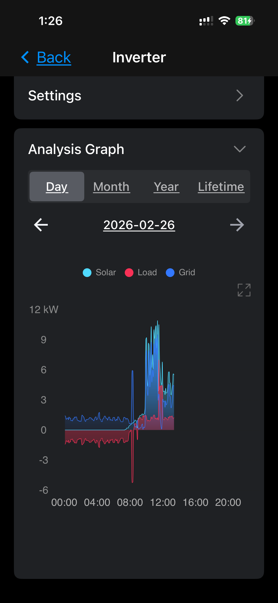

A picture from the App shows how the load seems to be tracking the solar power generated
Load should really have stayed at a pretty constant 1kW

Now it all seems to be reporting properly, going forward in the Web app.
However, data in the Iphone app is still not quite right. Load is reporting above the 0 line, not below.
Also, previous data is still wrong - my guess is they cant fix that.
See the last two images comparing the web app to the iphone app
So its close, but not quite right yet.
