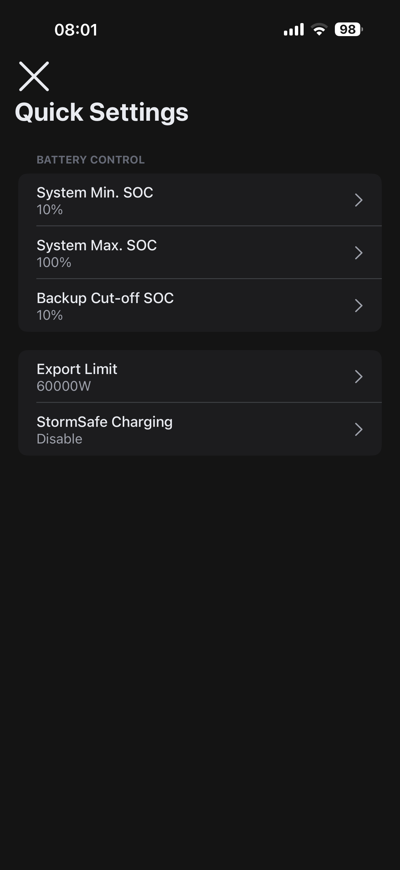

Today I wanted to change when the grid charges the batteries... and now, it's vanished!
I cannot find it anywhere.
Really would love some help, please.

Fox have been made (painfully) aware of the issue but for now you can go to the Fox website (link here https://www.foxesscloud.com/v2/login) use your existing app credentials and you'll find it in the top right a purple 'Quick Settings' button - in there is the option for the older Grid Charging time (2 charge periods), or if you use the Scheduler that will be just below.
