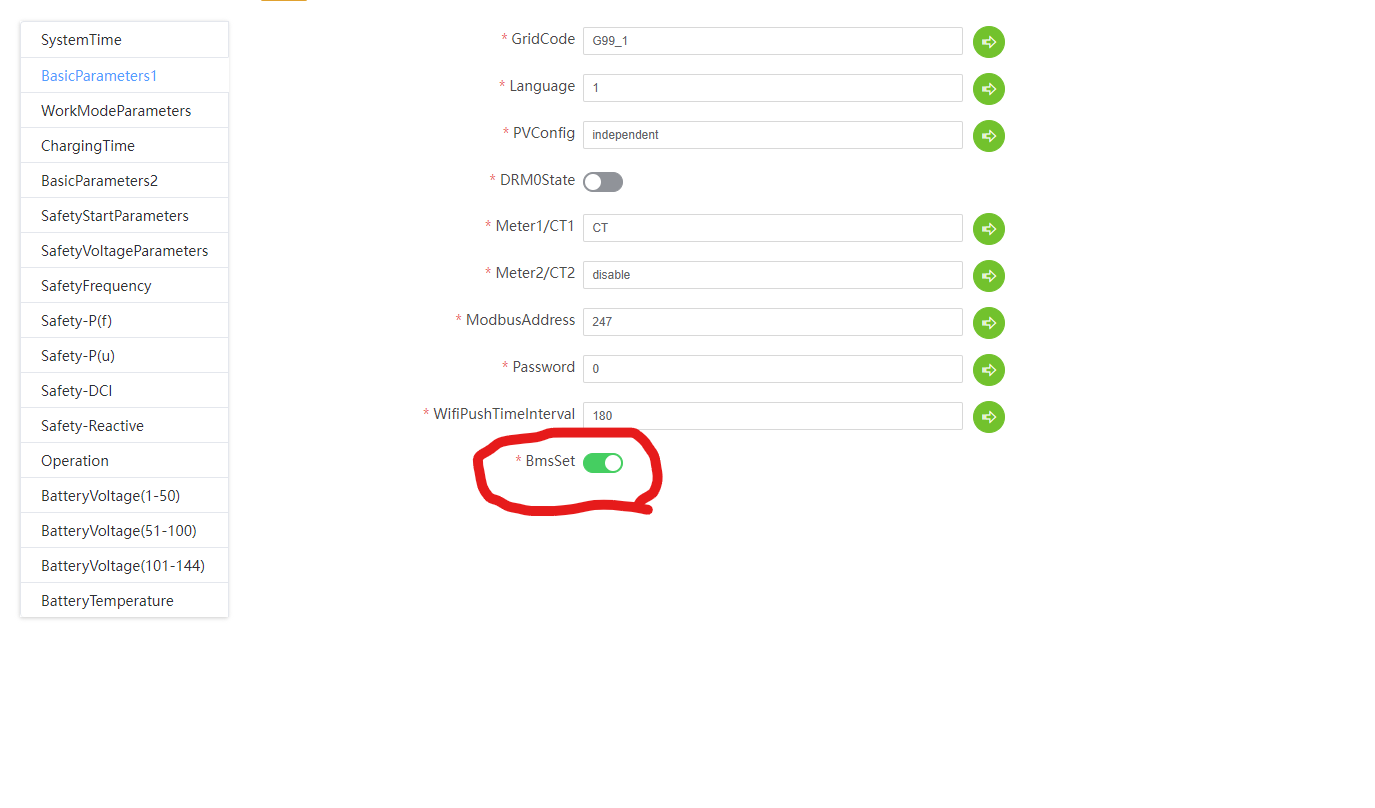

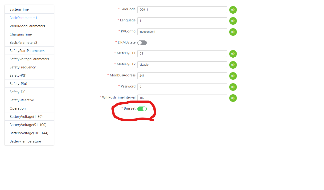

On the web portal
Once upgraded go to Inverter > Remote settings Icon > BasicParameters1 and disable BmsSet
Then go to the Operation section and click ClearEvents and you're inverter should no longer have any errors being disabled.
